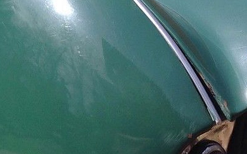

Paint job did not include the engine bay which may mean a budget job, certainly not top-drawer and probably not the 'body-off restoration' that is claimed.
Dent in bonnet and also a stone chip suggest it was driven quite a bit since painting.
Front bumper sits a bit crooked (not unusual on a 4) and chrome appears thin. Possibly took a bump on the left front in the past.

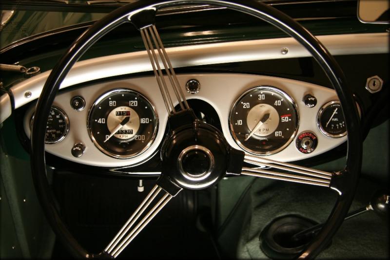

I've said this before, but I always considered the TR4 and 4A the best looking TRs, stylewise. Though slab-sided like the TR5 and TR6, the body design is more integrated, especially the headlights and tail lights. The TR2/TR3 is "cute" - like a sawed-off XK 120, and the TR6 looks great from the front, especially with the front bumper off (try it some time), but the view from the rear is less attractive - and I own one. The dash in all Triumphs is much more attractive than an Austin-Healey or even an MG IM(not so humble)O. Anyone agree? Disagree?
glemon
I think the TR6 is a good looking car, very well styled, most of the magazines praised the styling when it came out. But of course the TR6s have a much more 70s ish vibe, whereas the earlier TRs are all chrome and curves and vintage sports cars feel. I remember when I got my first 4A, I thought the big tach and speedo were so much cooler than the little things I had had in my prior Sprites and MGB/GT. However, the dash in a Healey Hundred is pretty cool too-Instrument-AH100.jpg
sail
Oh yea the Healey. I watched them go out of sight while looking for a car. Healey, TR and MG were in the running for several years before I saw a particular 4A that I liked, knowing little more than how to identify the different cars. The 4 is just kinda tuff looking. The 6 lost a lot of the appeal of the roadster for me, muscle car type. The car on ebay would have been worth watching for sale price but I would never have considered, too many cars out there to buy that one.
