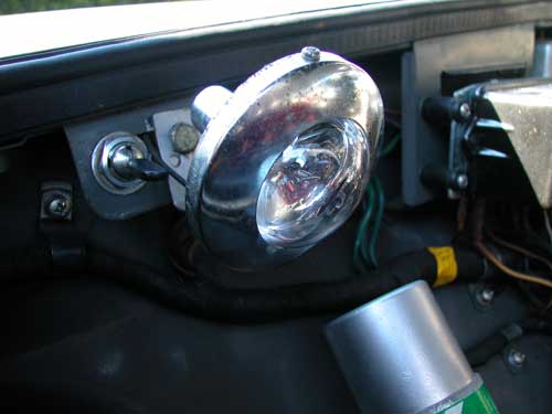

As for the light situation, the PO of my car had the foresight to install a period Lucas lamp in the engine bay. It comes in VERY handy when needed.
