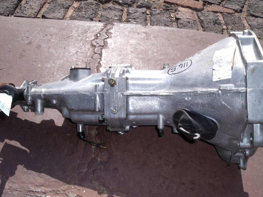

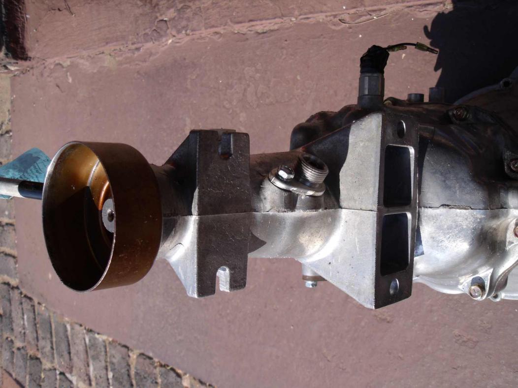

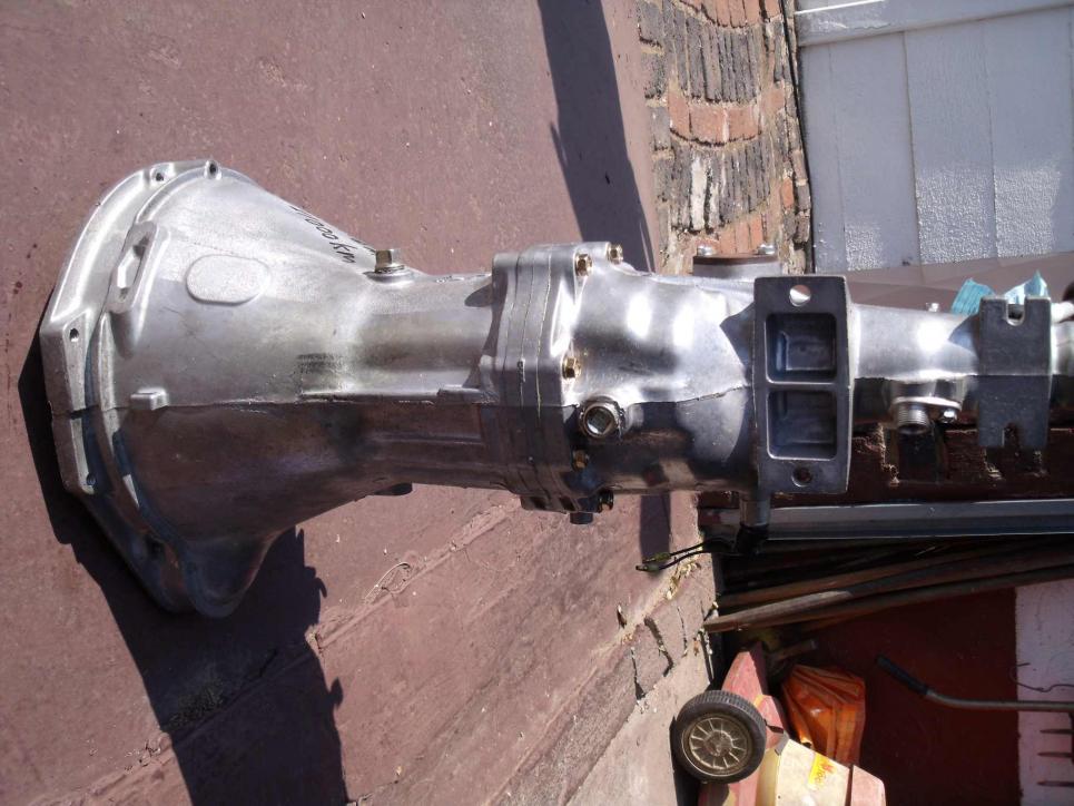

It's a pity this didn't come up about 3 months ago, I had both pieces in my hand and could easily take some photos. They go for about R350 = $40. I will try to take some from underneath. I'll attach some pics of the gearbox, this is actually one bought for another Sprite late last year

Ah, yes... already knew of these trucks as I have heard from a couple people in South Africa wanting to buy one of my conversion kits. Originally I thought you were referring to passenger vehicles. The gearbox appears to be essentially the same, though I notice a few casting differences. The major difference is that the one supplied in these trucks (pictured) is a cable operated clutch, so some case modifications would be necessary to make it work in the Sprites or Morris Minor. I'm pretty sure the fork is different as well. Do you have any pix from the side and viewed into the bell housing? Also, if you get your hands on a yoke or U-joint, could you put some calipers on it and measure the diameters?
