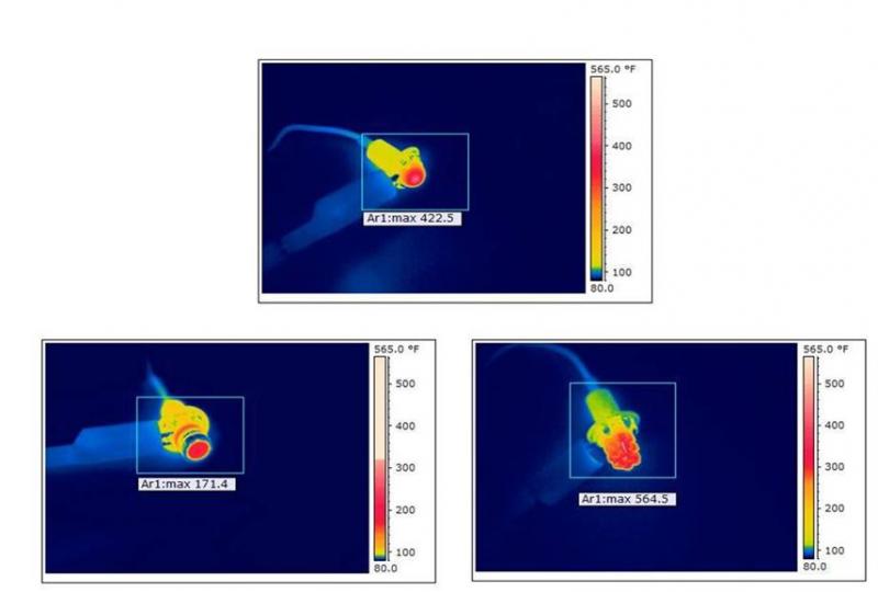

Everyone who is considering LEDS should be aware that all LEDS are not created equal. I purchased some for my instruments on eBay, they were very bright but also ran very very hot, over 564 degrees Fahrenheit! Way too hot to be inside any of my instruments or behind my dash!
I then ordered the two Moss Motors has for sale, they measured 240 Fahrenheit for the multi-element LED and 171 Fahrenheit for the flat LED. As a reference, the stock incandescent measures 423 Fahrenheit. (See infrared images below)

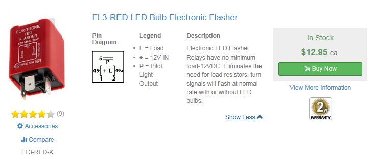

I also have LEDS for all of my brake, turn signal, and running lights, utilizing the flasher unit from https://www.superbrightleds.com/ (See image below) which does not require any resistors or any other additional equipment or modifications.

Top Image: Stock incandescent
Bottom Left Moss Flat
Bottom Right: eBay LED

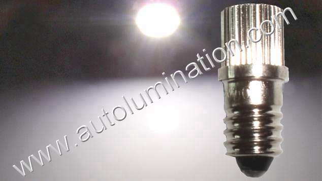

Ray, if you're going to use the superbright LED in the directionals, consider using them in the high beam and ignition too. (Moss does not recommend using them for directional nor ignition. I've not had any problems in over 8 yrs. I found using them in the directionals made such an improvement that I can see it during the day)

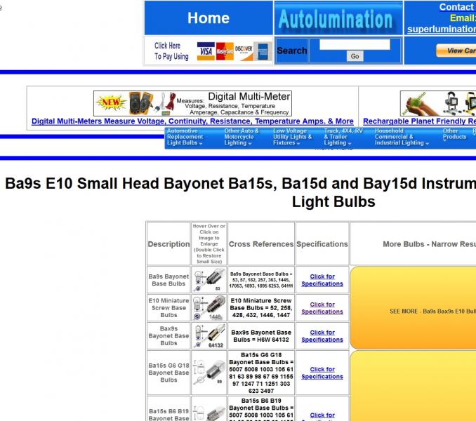

Make sure you get the ones like I used, as I tested a lot of led and the one below was the best.
https://autolumination.com/otherleds.htm
E10 superstar led Bulb, 1449 E10 Screw Base Bulb

Can you provide a better link? I was unable, using the link above, to find the exact bulb you're advocating.
Can you provide a better link? I was unable, using the link above, to find the exact bulb you're advocating.????
IT is there Steve.
Copy the link and paste it in may work.
I just clicked on his link it it was OK

OH! Isn't the 1449 E10 the one you want Steve ???
1449 E10 Screw Base Bulb Replaces: 52, 258, 428, 432, 1446, 1447
Thanks Roger,
Orders will be placed and, hopefully, on their way soon.
