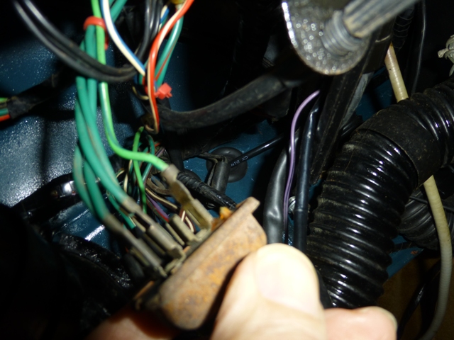

Can anyone identify this, it is hanging from the dash left side of steering wheel. Voltage stabilizer?
Looks like one..TR6 has it attached and grounded to the speedometer housing....not hanging loose
2 green G wires on the B terminal and a lite green LG to the temp gauge on the I terminal
So if it is just hanging, it is not grounded, which would affect anything connected to it? My temp gauge does not move with engine temp.
Yeah the wiring schematic shows it's grounded by attaching it to the speedometer case which is also grounded
I suppose you could just test it by attaching a jumper wire from the stabilizer case to a good ground.

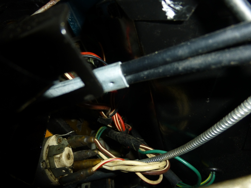

For icthos; from the passenger well the red & R/W. I would have to remove the radio to get my hand up there, might be able to take the rheostat out from the front if there is enough slack, but have a feeling there is no power to it.
