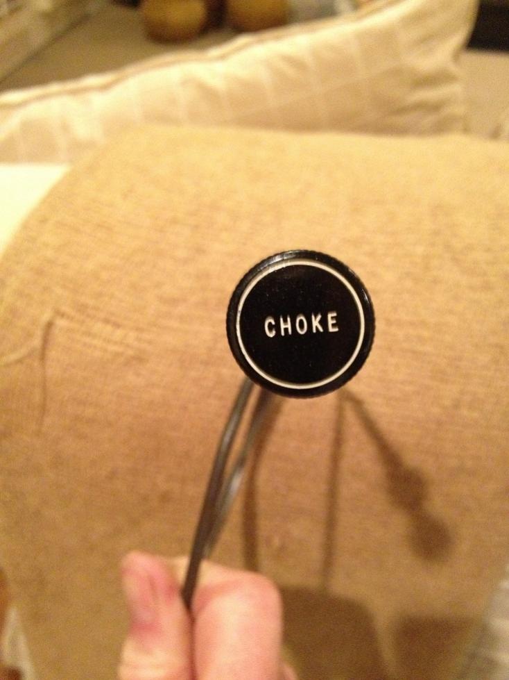

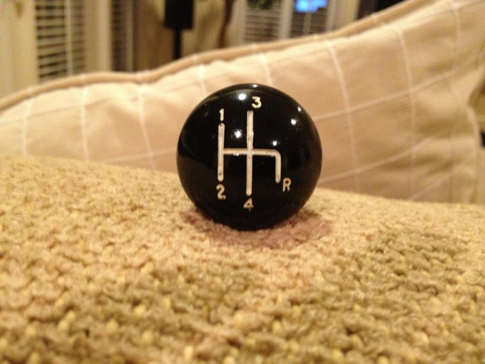

I've restored several knobs. I paint the areas white that should be with a small jar of auto touch up paint. I make certain that I get the white areas covered well. Then I take 600-100-1500 grit sandpaper in sequence to gently sand the white off everywhere it doesn't belong. Once finished to my satisfaction, I clear coat it. Here's are examples.
Heh, I was talking with restoration shop about the lettering issue... He said to use a product called "Dalo" industrial paint marker to fill in the resesses of the letter..Sounds awsome!
