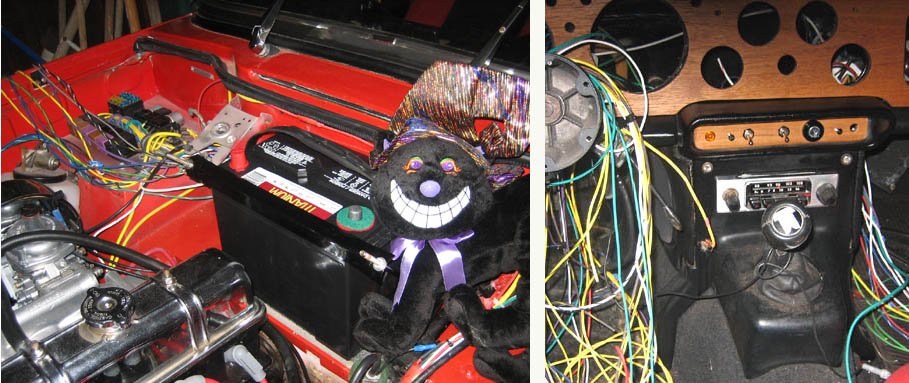

Well, finally some good new concerning the Crypt Car.
Most of you know I have been struggling for 4 months now
to replace 100% of the wires in my 69ish TR with the
splendid Dan Masters wire harness.
But it was simply beyond my limited capability. So
Dan's son Mike is graciously arriving at the San Juan
airport this afternoon to spend a week with me fixing
all my mistakes and getting all the wires functional.
Anticipating a successful week, I replaced the PO battery
(375 amps, $29 special)with a new 825 cold crank amp model
listed for TRs.
I know many folks have all kinds of problems installing new
wires in their old Brit cars.
During the week, as Mike works thru the wire install,
I will post some how-to photos back on this thread.
If all else fails, Mike and I have already decided to
switch out the Crypt Car headlights for two nice, electric
plastic pumpkins. The Crypt Car will look great for
Halloween one way or the other.

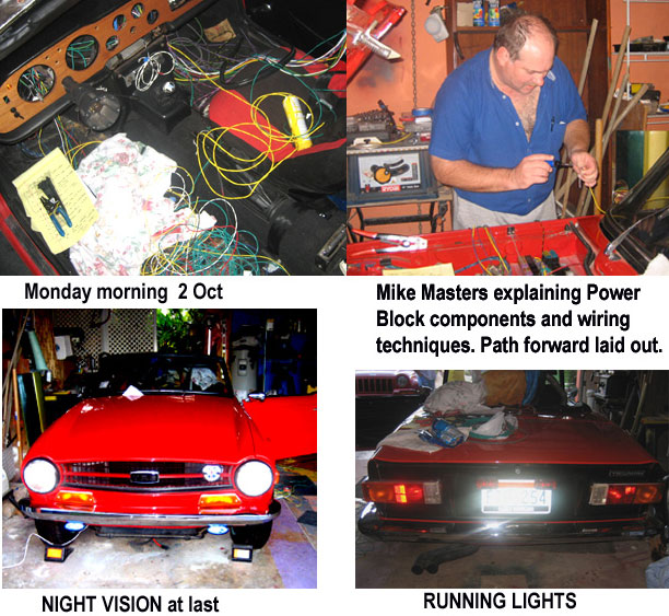

Awesome!!! A 100% successful, upbeat day.
Master Mike did a QA on the Power Block,
(damage assessment actually!). Mike
quickly put together a game plan and path
forward. Muchos instrucciones on wiring theory
and installation technique.
Order began to take shape from chaos. The wire
clutter became wire bundles behind the dash area.
The front end wires began to meet up with the
rear end wires.
Mike's goal for today was 100% functional exterior
running lighting with proper connections and tight
QA.
5:30 PM this evening, Mike connected the new battery,
Dale threw the column mounted light switch and behold...
THERE WAS LIGHT
Front end and rear end, high beams and low beams,
running lights, markers and license plate lights.
Totally AWESOME day !! I toiled for 4 months with little
success and in one single day Mike Masters has the Crypt
Car 50% toward being cranked up and street legal.
Thanks Mike, Thanks Dan !!!
Tomorrow- turn signals, brake lights and the
dreaded dash.
Enjoy the photo attached
Dale and Wendy in Bayamon, PR

Update of the Crypt Car wire harness:
2:00 PM and we are taking a food break.
All exterior lights including turn signals, emerg.
flashers and brake lights fully functional.
Ignition switch and cut out switch installed and proved.
The Crypt Car attempted to start!!!! Actually cranked over a few times before we cut off the key.
A sucessful day. Off to find my buddy with the carb knowledge to final install Jeff's carbs.
Crypt Car might be functional by end of day!!
