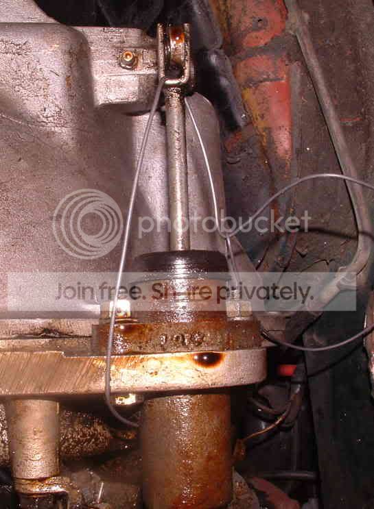

Have some baling wire handy when you remove the clutch slave, so you can tie the pushrod into the cylinder. That way you won't have to open the hydraulic system and bleed it afterwards. The cylinder can just hang on the hose. (This is my Stag, which is a bit different, but the concept is the same)

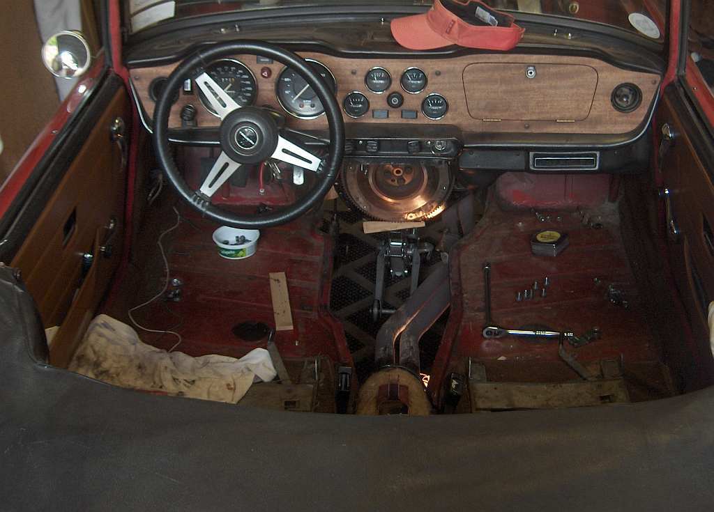

How does the clutch pedal feel? Is the lever on the transmission moving when you work the pedal? If so, start taking the car apart. Since it is your first time, go ahead and remove both seats. Then the center console thing, and take the carpet up. Unbolt the bolts all around the transmission cover. If it is an overdrive car, you may have to loosen the handbrake handle, but you might be able to get the cover past it if it is pulled up all the way and the gear lever in reverse. Then you can unbolt the drive shaft and rear mount, block the engine up, and unbolt the starter and all the other bolts around the bell housing. You can then pull the tranny out through the cockpit. Inspect the forks and throw out bearing, and the pin Don was referring to. Chances are they are okay, it is the pressure plate that is suspect. Remove it from the flywheel. It may come off in pieces. Also, your clutch disk might be shot. It is best to replace them together, since you have it apart. A new throw out bearing is a good idea too.
I hope this helps. Good luck!
Dan B
Thanks for the tips and the pics. Im going to attempt the dismantle starting tonite and I will let everyone know what I come across and what happens for those this may happen to in the future. Wish me luck and I will use everyones advice as much as possible.
