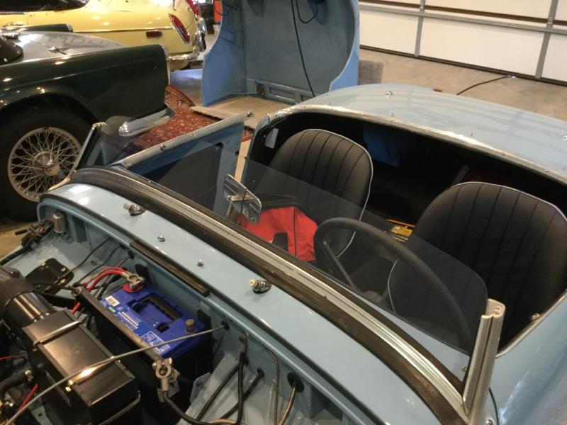

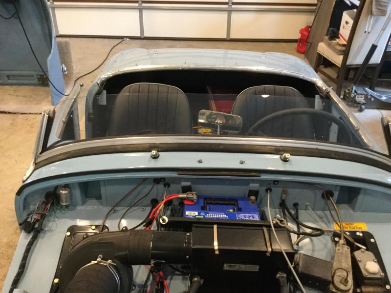

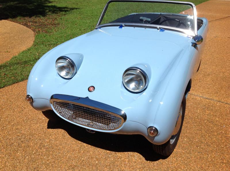

I meant to post this awhile back, but better late than never. I ended up going with 1/4” polycarbonate and it was easy to work and the edges polished out nicely.

Nice job on the screen... sort of a continuous Brooklands thing.

I've seen these for sale - pretty pricey. Did you do this yourself? If yes, can you explain how you did it?

It was a lot easier than I thought it would be! I posted a want ad in the BST forums for a complete windshield frame and found one for $50. I cleaned it up and cut the frame and uprights at the height I wanted and drilled/tapped a new mounting hole just below where the original center hole was located. I ordered a windshield gasket from Moss which was the most expensive part of the project and a 1/4” thick piece of 12”x48” Lexan via the internet. I used a template I made from my old windshield and cut the Lexan with a jigsaw/polycarbonate blade and finished the shape with a mounted disc sander. I used 80 grit sandpaper on a 12” long piece of 1x2 to finish the shape and make everything straight and true followed by progressively finer sandpaper down to 3000 grit w/d which left a nice polished edge. It was a fun project and I’m going to modify the height of the frame and uprights to give it a more finished look. The Lexan is tough and flexible, very easy to bend and insert into the rubber windshield gasket. Probably about $150 total in the project.

Thanks for the instructions. I think I might try the same thing. Can you tell us what you are thinking when you say you want to modify the uprights to give it a more finished look.

looking at my 2nd picture you can see that I cut the frame and uprights off at the same angle in relation to the body of the car. While the angle is not the big issue to me, I think it would look much better if the frame and uprights were cut off lower and some type of cap or filler made to finish the top edge. It could be something as simple as a piece of 3/8” thick plate welded to the uprights and shaped. Thoughts?

I like the look and what you’ve done overall but I do agree that the uprights need to be finished off. Looking at then from the front I would recommend a radius similar to the windshield. Form a cap out of maybe 1/8 inch aluminum and have it welded in and then finish and polish it.
I didn’t know Bugeye guy had one and I like the shorter uprights, but I almost had heart failure after seeing the price! I think I’ll cut mine a little lower and tig some caps on, then grind them into a more pleasant shape.
