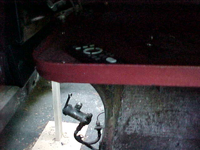

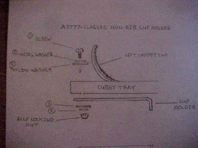

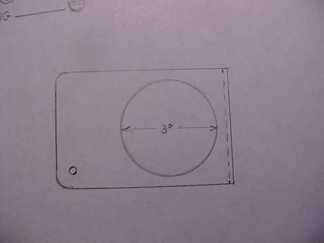

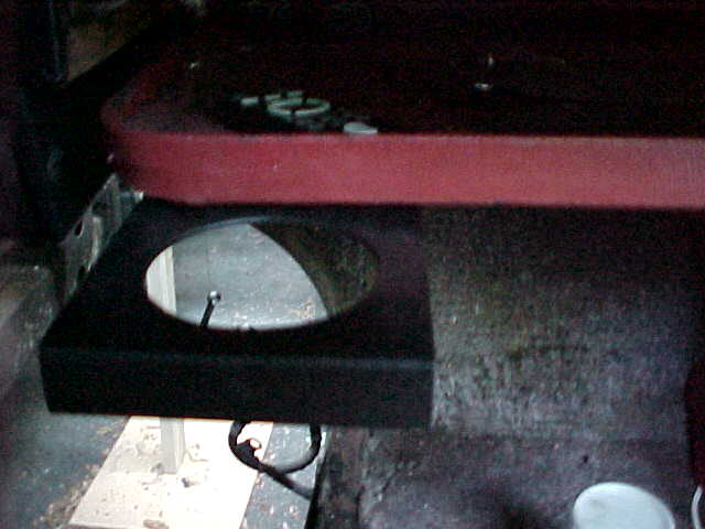

gents lots a stuff goin round bout "cup holders" for bj8's well heres one i did for my bj7 (cuz they rule) it simple, hidden when not in use, the 3" center hole will accommodate most small and large cups,inexpensive,quick to make, the plastic piece i used for the holder itself came from a directional valve from a central shop vac. of course metal can be used for this but i found the plastic will flex when you hit a bump and not splash your favorite beverage into the cockpit. enjoy and "happy fathers" day to all. /bcforum/images/%%GRAEMLIN_URL%%/savewave.gif
