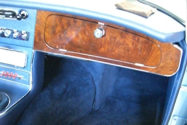

I was at Roger's house today, providing my own brand of inspiration and encouragement as he installed this cup holder in his BJ8. I just want to say that this is one slick setup... very stealthy and a simple, straight forward installation. It will only work on a BJ8 however.
The cup holder itself is a well made unit that is supplied by Mercedes Benz. Many of you may want to take a different road because of the cost. But for those crazy souls with a desire for pure stealth and the ultimate-Healey-cup- holder convenience - this is it.

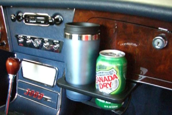

Hi Ed,
Yes it is attached to the glove box.
I certainly know what your thinking. Cardboard?
My glove box is new. I don't know what it is made of, but if it is cardboard, it is really hard.
Most of the load is secured at the front of the glove box where it is screwed into the wood face.
I used JB weld to glue the aluminum beams to the underside of the cup holder housing. Then screwed sheet metal screws through the hard glove box "cardboard" into the aluminum beams. I used washers as shims to level it.
The cup holder is a VW part.
About $70.00.
Who says you can't put a price on cool and pleasing the "WH".
The part is very strong and my installation is very secure. I certainly would not want this to break lose and spill hot coffee on my passenger.
I must have tried 8 different cup holders from Audi, VW, Camery, Hundi, Corrolla, Porsche and Honda.
Trust me, I spend a lot of time with trial and error before I make my final choice permanent.
Ask my friend Randy.
Cheers, Roger

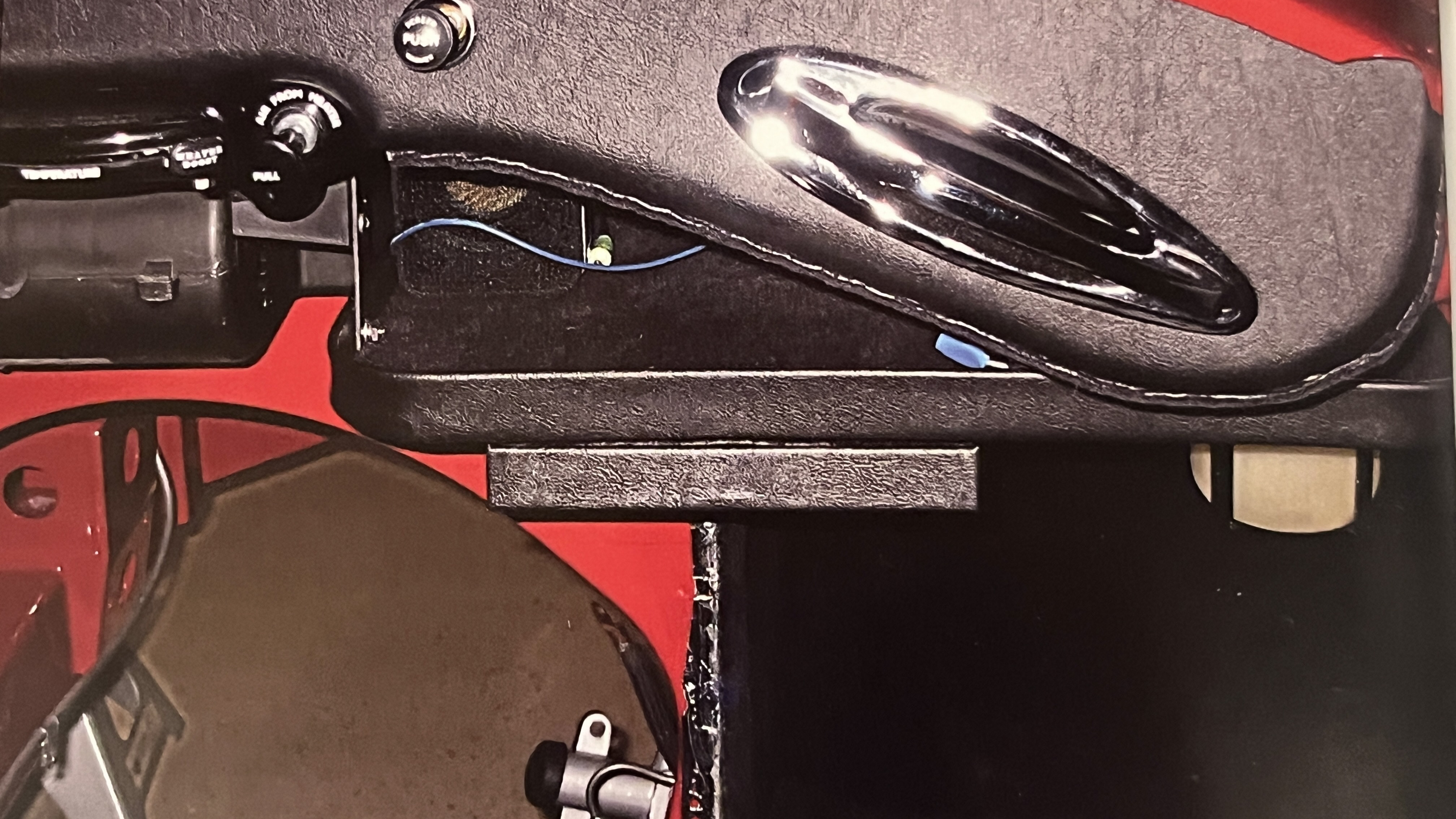

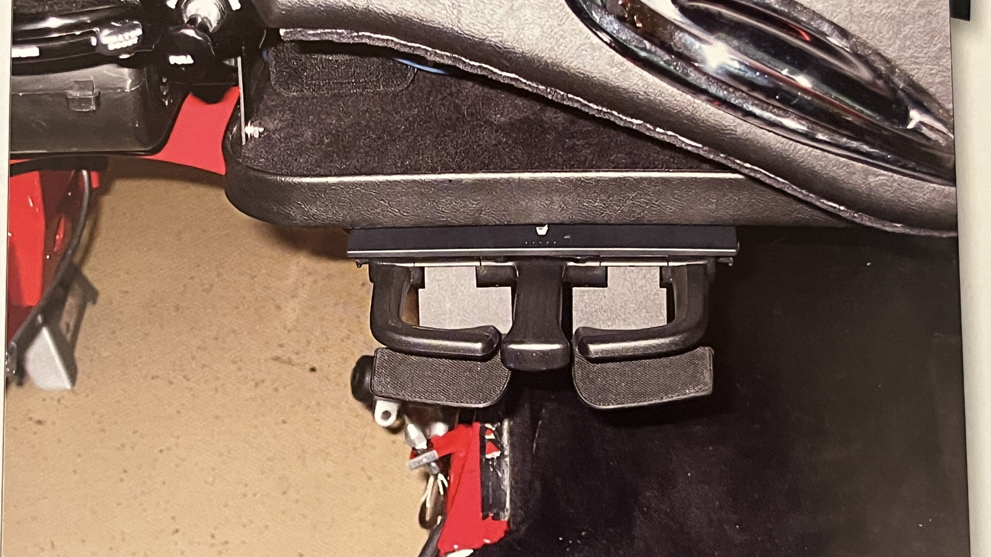

I have had some questions about how the cup holder is made and held in place. Seems my previous photos on Flicker are no longer posted. Here are some, that should stay on this site.
The VW cup holder I used is an older design (part number 1J0 858 601) that has been replaced by VW with part number 1J0 858 601D (first photo)
The newer case is the same size and both work by simply pushing on the front when closed and it will slide out and lock in place. Lift the bottom cup holder bracket and push the front in to slide it back in the case and out of sight.

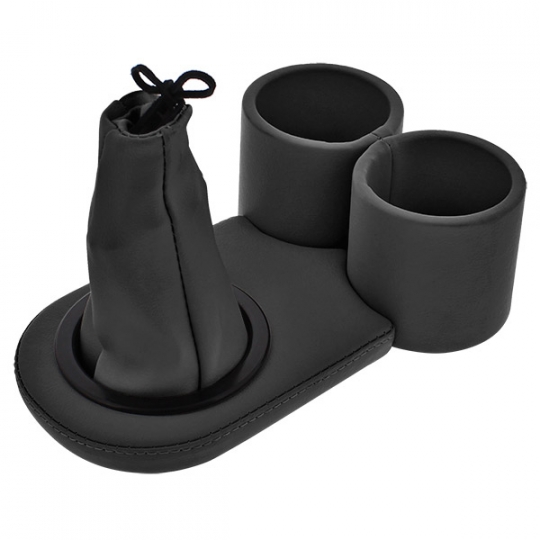

I mounted one of these on the tunnel of my 100 (I have a Toyota five-speed with the shifter in the rear-most position).
It is made by Cupholders Plus and it is attached via one #14 oval head tapping screw w/trim washer.

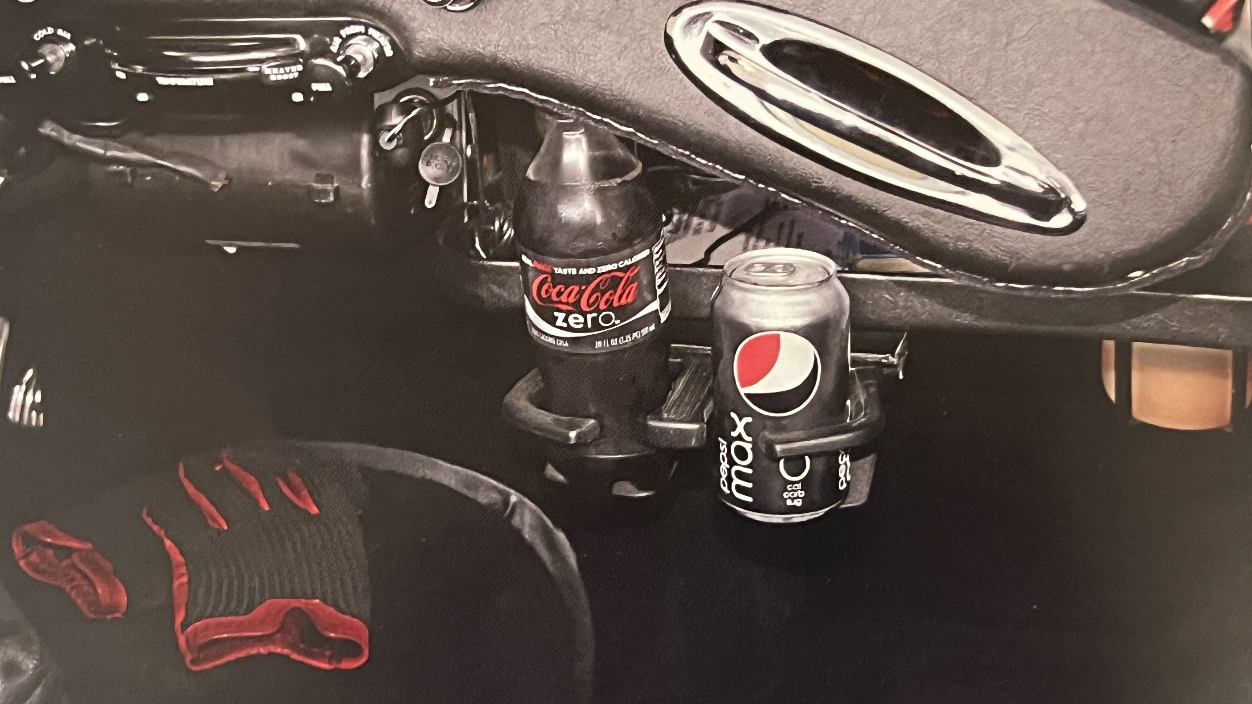

In 2009 I co-wrote with Linwood Rose an article in the 2009 Healey Marque; Healey Hidden Cup-Holder How-To.
Linwood BT7, Roger BJ8
Here's some photos of Lin's fine craftsmanship!
Still works just fine! Thanks, Roger.
