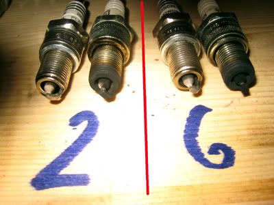

Started at ground zero this morning and fine tuned
EVERYTHING but the firing order. ( I have THAT maked on the
dizzy, marked on the block and marked on each plug wire
and tatooed on my left elbow.) /bcforum/images/%%GRAEMLIN_URL%%/yesnod.gif
New plugs, gap .025, in the photo have 20 minutes (on jacks)
drive time plus warm up time on them. Compare to the plugs
I removed after Crypty started acting up.
It appears I have two carbs and an ignition system in
proper running order. Looks like a real winner to me.

Howdy, I haven't been following your posts lately....to painful. How did the float biz problem turn out?
While I'm here,I'll add my 2 cents, throw those bosch platinum plugs in the toilet. They foul out like nobodys business.

Whats in the pic you show? Std Bosch or What?
You may want to try the Platinums for the heck of it; It would be a Cheap Test:

Looks like its running a little fat, but thats par for course.
Dale,
The carb / fuel system problem gunked up the old set of plugs. That kind of color is caused by unburned fuel.
Hang on to them since they are not the least bit worn (they aren't Pedro's are they?) Just clean them up between the tip and the electrode, (nothing rough just a very gentle brushing will do the job) and take them for one of your wild rides, the rest of the crud will burn right off.
Yisrael
Thanks Yisrael!
I was going to throw them in the trash. Yes, they are
my new install- not PDO Pedro's. They have maybe 100
miles on them. I'll clean them up and keep for spares.
