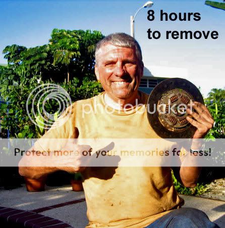

So I tackled the clutch today- 8 hours worth. Something
called a freakin' fork pin was busted and it took 2 hours
with a torch to burn the fork and long bar out of the
tranny housing. Here's a few photos- any and all advice
or tips will be greatly appreciated.

Ok, a photo for the flywheel guys.
Not that good a photo.
The flywheel to me has a mirror finish- it gleams.
I can detect no ridges, lines, impressions or other
irregularities. No outer teeth were missing or broken.
The black disk that pushes up against the flywheel
was also smooth on both sides and NOT worn down to
rivets. It appeared polished. I dropped it off for
Caesar to view and he said it was worn out but not
enough to have damaged the flywheel.
I told him of your offer Bill. Caesar said he will
take a look at the flywheel on Monday or Tuesday and
let me know whether to request your flywheel.
From what you can see and I viewwed , what do you think?
thanks-D

Good effort.
You'll be on the road before I am at this rate. (It's 25 degrees and way too cold to be in the garage).
Re: Crypt Car News Update
I see that you are dirty, but I am not seeing any blood. Are you sure you did this project, I am suspecting you added the dirt for the photo. /bcforum/images/%%GRAEMLIN_URL%%/laugh.gif
Looks pretty burnished. Definitely needs to be refaced. Probably ok to use after getting it turned.
Dale, along with checking all the usual stuff, you better check the mounting surface of the bellhousing for cracks, because if that Cabron PO only put a couple of bolt to hold the engine and trans together some local overstress could have occurred. /bcforum/images/%%GRAEMLIN_URL%%/frown.gif
Mark: Since I know very little about auto
mechanics I learned very quickly I was getting
bloody mostly from trying to loosen rusted or
tight bolts.
I began to use leverage to become a bloodless
mechanic. I use different lengths of pipes to
extend my wrenches and socket handles.
I scratched my elbow today and that's about it.
But I DID have to use oil and grease remover to
shampoo my hair tonight. The water ran black from
my head.
The photo was actually cleaned up. Wendy would
have my head if I had gotten oil and grease all
over my brand new Wrangler.
What I accomplished today is I got everything
out and taken apart. Next come the rebuild.
d
