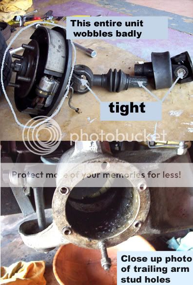

So, you've found you need to upgrade the stud problem.
When you either helicoil or go to slightly larger diameter studs. Strong recommendation is that when you do, go to coarse thread studs where they mount into the aluminum. Use red locktite and that should do it!
Dale from the way it looks, those can be repaired with the Time-serts which were recommended. I have used similar inserts on my car to repair striped out aluminum (I used E-Z LOK inserts). According to the Time-sert data sheets they are very thin so clearance wont be a problem even though they have already been repaired once.
Find a good machine shop around you, they have accurate machines for milling and will be able to line up the holes properly. The inserts themselves shouldn't cost more than about $1 each, at least thats what the e-z lok inserts cost. They will be stronger than original when done.
I am guessing that those are 5/16th (0.3125")
The Ezlok "thin" inserts require a 7/16 hole (0.43")
The time serts need a "P" drill 0.323"
Measure how large the holes are now, and then you can decide which type will work best.
The e-z lok type are available from McMaster-Carr .

While there are many good valid suggestions on this thread on how to repair the TA, from watching your trials and tribulations with local resources IMO getting a good used TA from the States is the best way for you to go.
At some point in time, as AWEMAN stated, the only source for these items will be old ones, like yours, that will have been rehabilitated.

The local island talent installed those helicores that
failed on me with my wife in the car. Nuff said?
I've got the Armstrong shock unhooked and the T/A lowered
with the coil spring out of compression. Next I'll pull the
T/A out and box it up for Paul.
When Paul's T/A arrives I'll install new bushings, bolts,
nuts, rubber pieces, etc. I'll pay a mechanic to make a

I'll send you the right side TA that I got from ebay after I check it out a bit more tomorrow. There are two studs missing, that may have just come out when they took the nuts off. I want to run a tap in those as well as running dies over the existing studs to make sure they are OK before I send it to you. I also want to check it for cracks.
If this works out, you can pay me what I paid for this one and the shipping to you.

Luckily the spare T/A's that I bought on eBay a while back are OK.
The right side needs studs, which I took out to check the threads. I re-tapped the threads, actually just chased them with a tap and now it will go to it's new home in sunny Puerto Rico. /bcforum/images/%%GRAEMLIN_URL%%/laugh.gif
