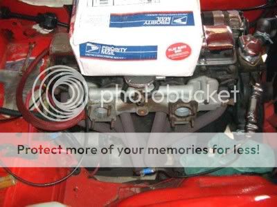

PS: Just remember Folks... We have Come a Long Way from Here,
(Powerblock in Box)
