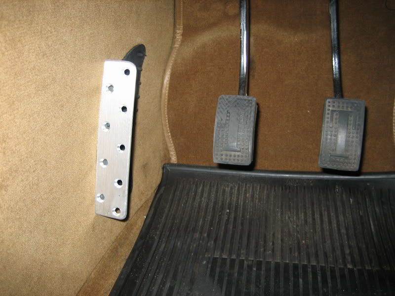

In my installation, I mounted the aluminum plate to the original dimmer switch mount and moved the dimmer switch higher up on the plate. A little awkward for using the switch but not bad. If you look at the picture again you will almost see the mounting screws directly to the left of the clutch pedal. I also put non skid tape on the plate. I find the plate useful for a little resistance exercise for my left leg when driving.

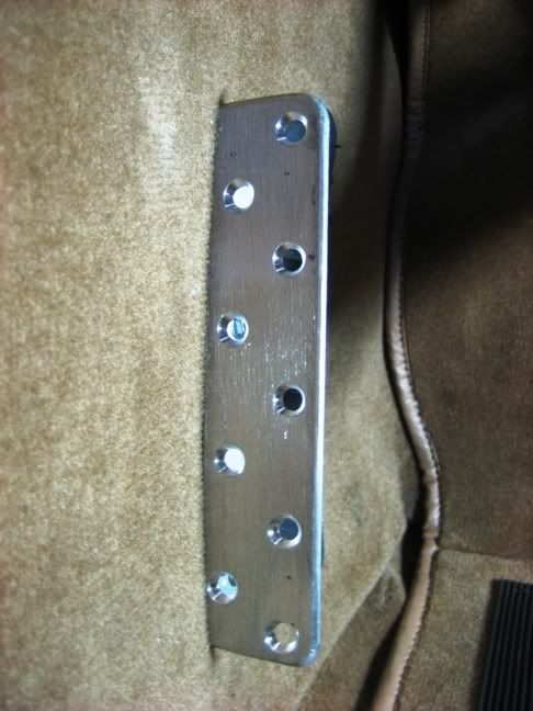

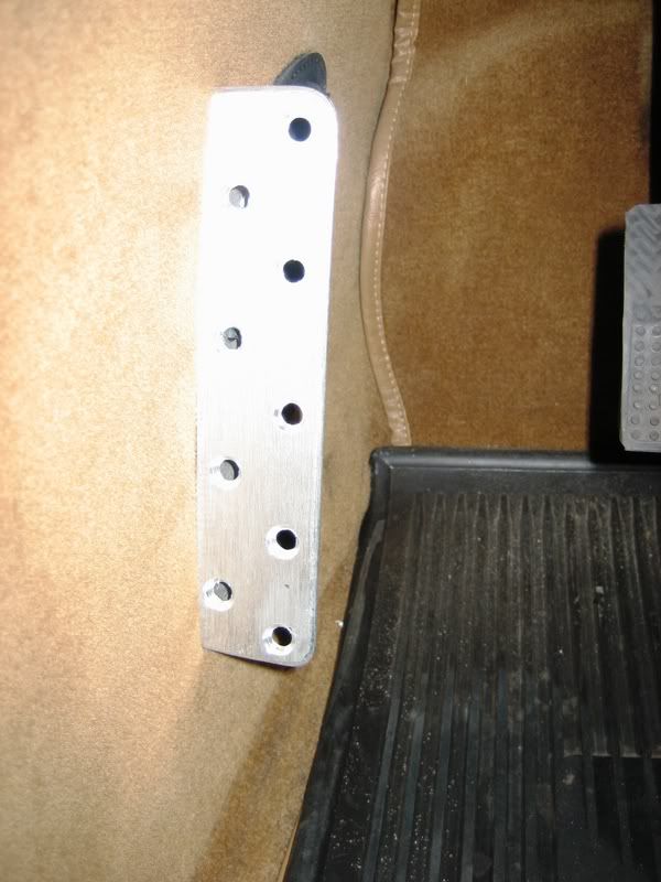

Dave - here's a few closeups. As always, Tom the Frugal Zealot stops at nothing to save a few bucks.

Yes, this is the one that I found while searching on the web! The aluminum (aluminium) looks great. Did you do this?
Yes , It was really very easy & it works great. All you need is a piece of aluminum angle 1-1/2X1-1/2X8". I drilled hole & brushed the finish for cosmetics.
There will be a more detailed article in one of the up coming 6-Pack editions, I don't know when though. If you need more info or pics let me know.
