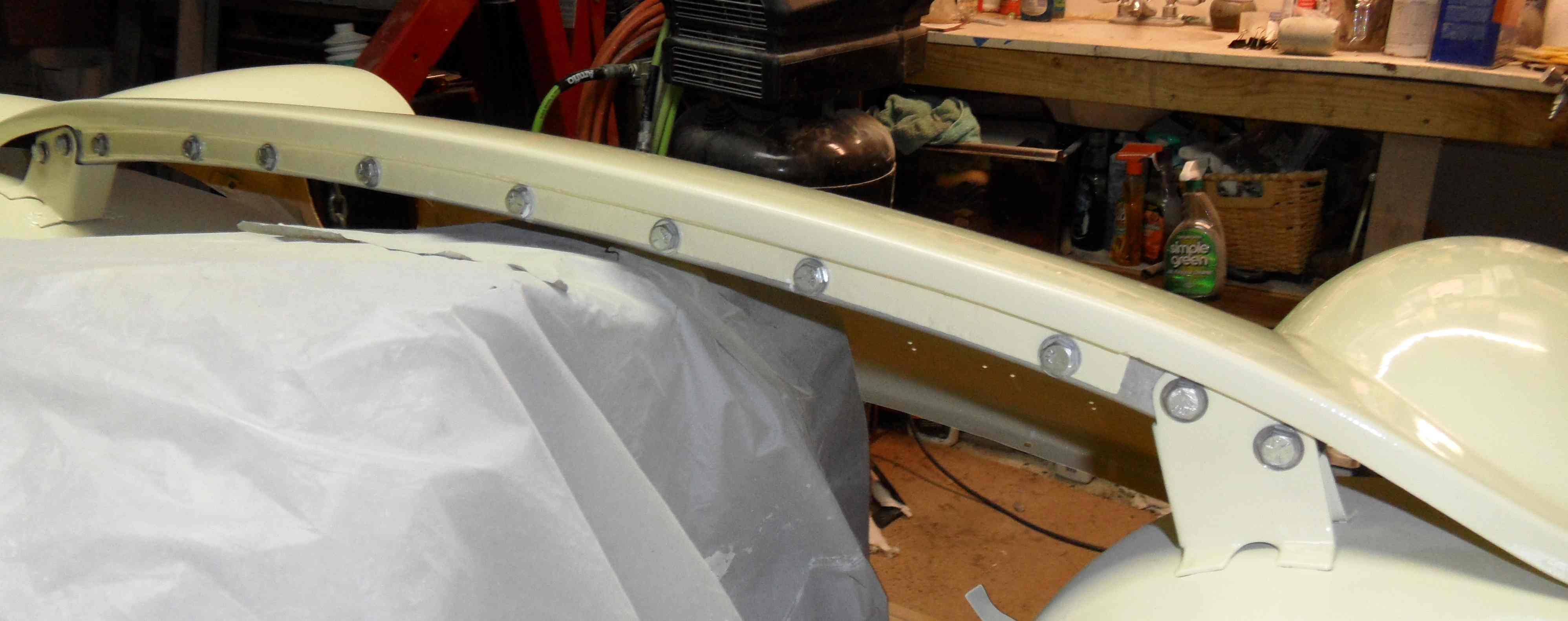

I just walked into the garage and took this picture for you. I painted this apron about a week ago. It's one of the PPG cross numbers for base/clear Primrose Yellow. Note, I chose to not paint the aluminum support rail, or the stainless bolts, and the spring/latch mechanism is not yet installed.

Yes! That's the exact picture I was looking for! So it looks like the issues with the front apron are as I described earlier; no more, no less. Hope is continuing to build!! If time allows, Mr. Knucklehead, can you snap a picture of the front where the grill goes in? I can take these pics to my body guy and see if he can narrow down a price for me.

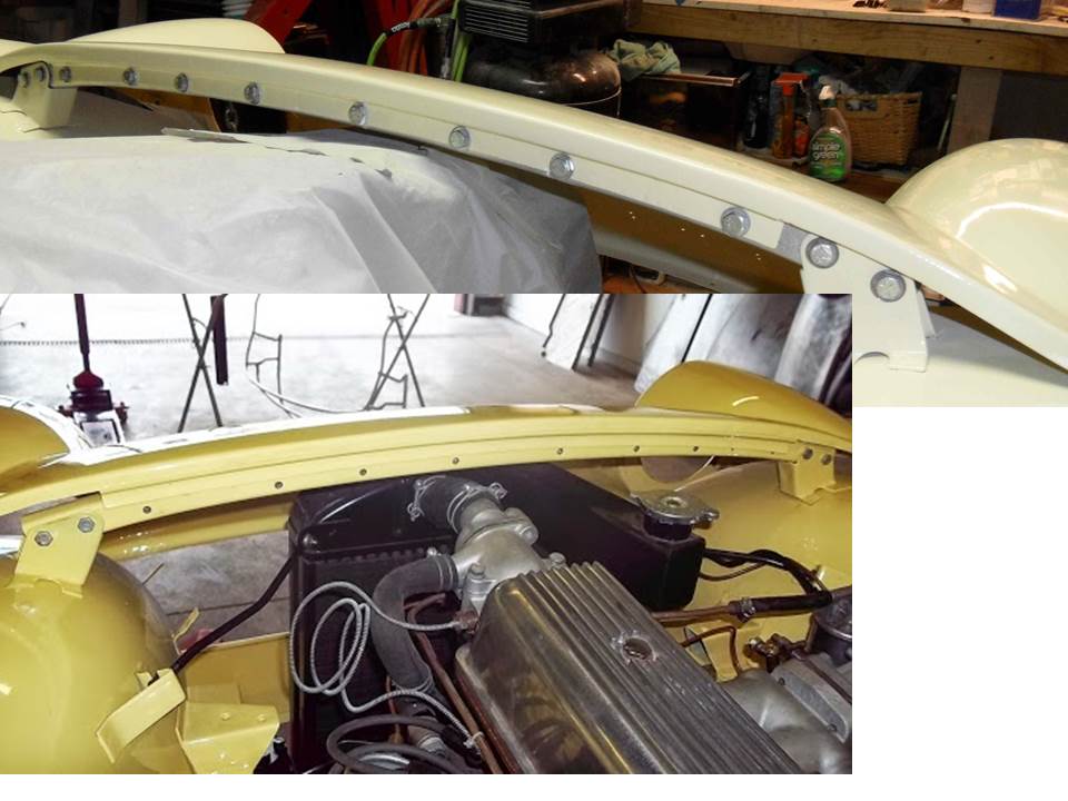

Not sure if you can tell with these pictures. Does appear to be another issue with the front apron (comparing Mr. Knucklehead's top picture with mine below). It appears my apron is "sitting higher" on the front of the car. I've always suspected this repo front apron was "longer" then the original. All I'd be worried about is whether or not I could get the hood to line up.
