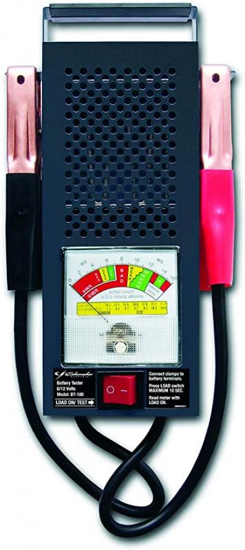

Can you test the battery strength? Voltage doesn't measure strength. Do you have access to a battery load tester like this:
Click the image for a close up.
It sees how much strength the battery has under load.
If you can't find one, turn on all the lights, including high beam headlights, and any other electrical devices. Then blow the horn and see if the lights get really dim.
its a brand new battery and i charged it over night.
