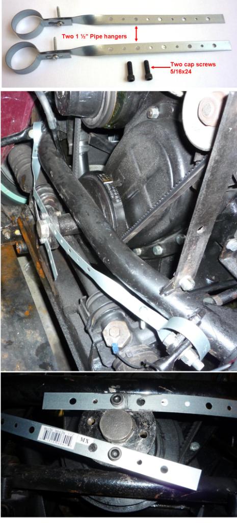

I just finished changing my head gasket and am trying to get at the front engine oil seal... To do so, I have to remove the crank end bolt. The engine turns over quite easily when I tug at it. I was wondering what any of you do to stop the engine turning over... Put it in gear with handbrake?

Here's what I did.... you can also use an impact wrench.
