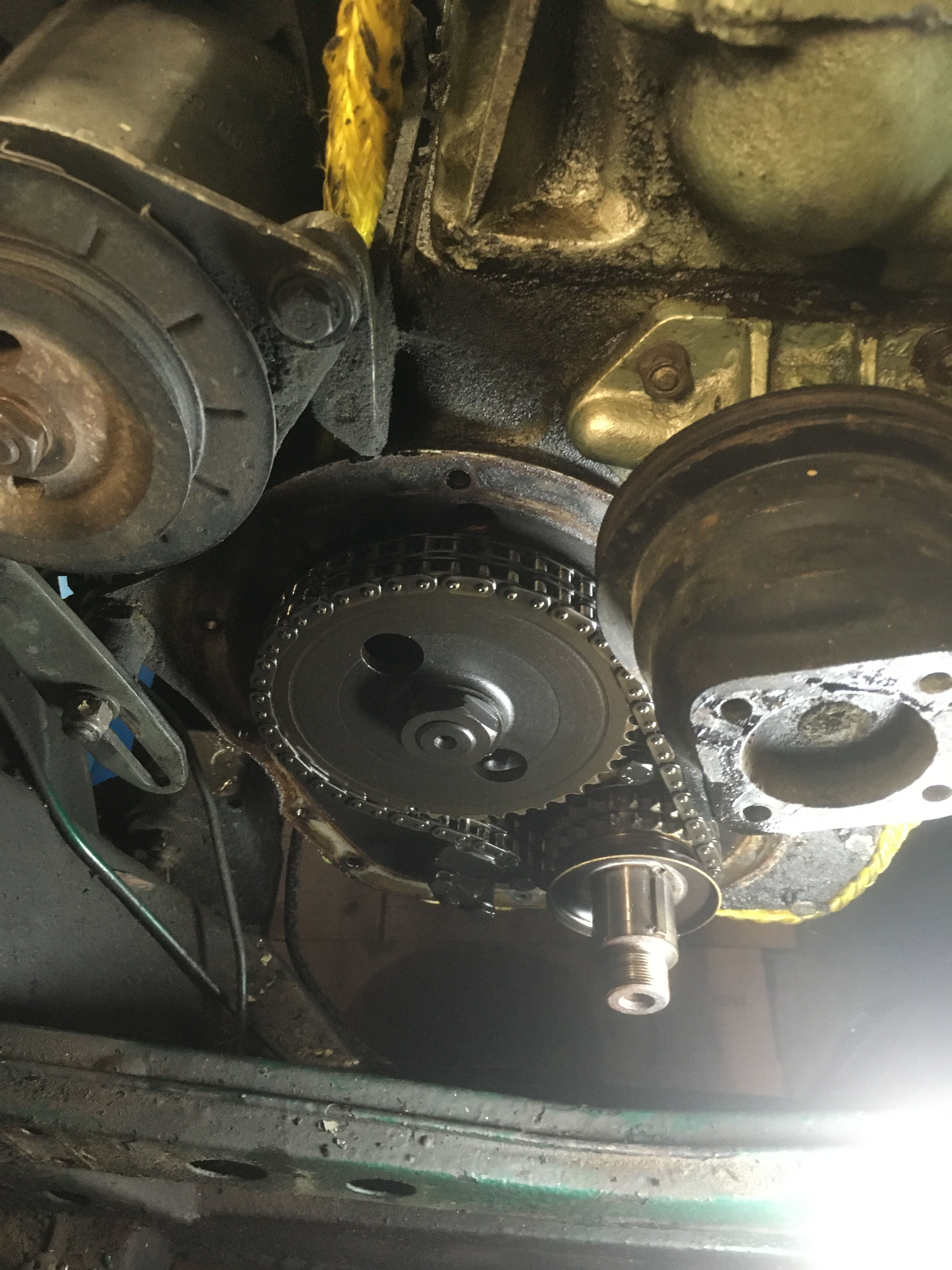

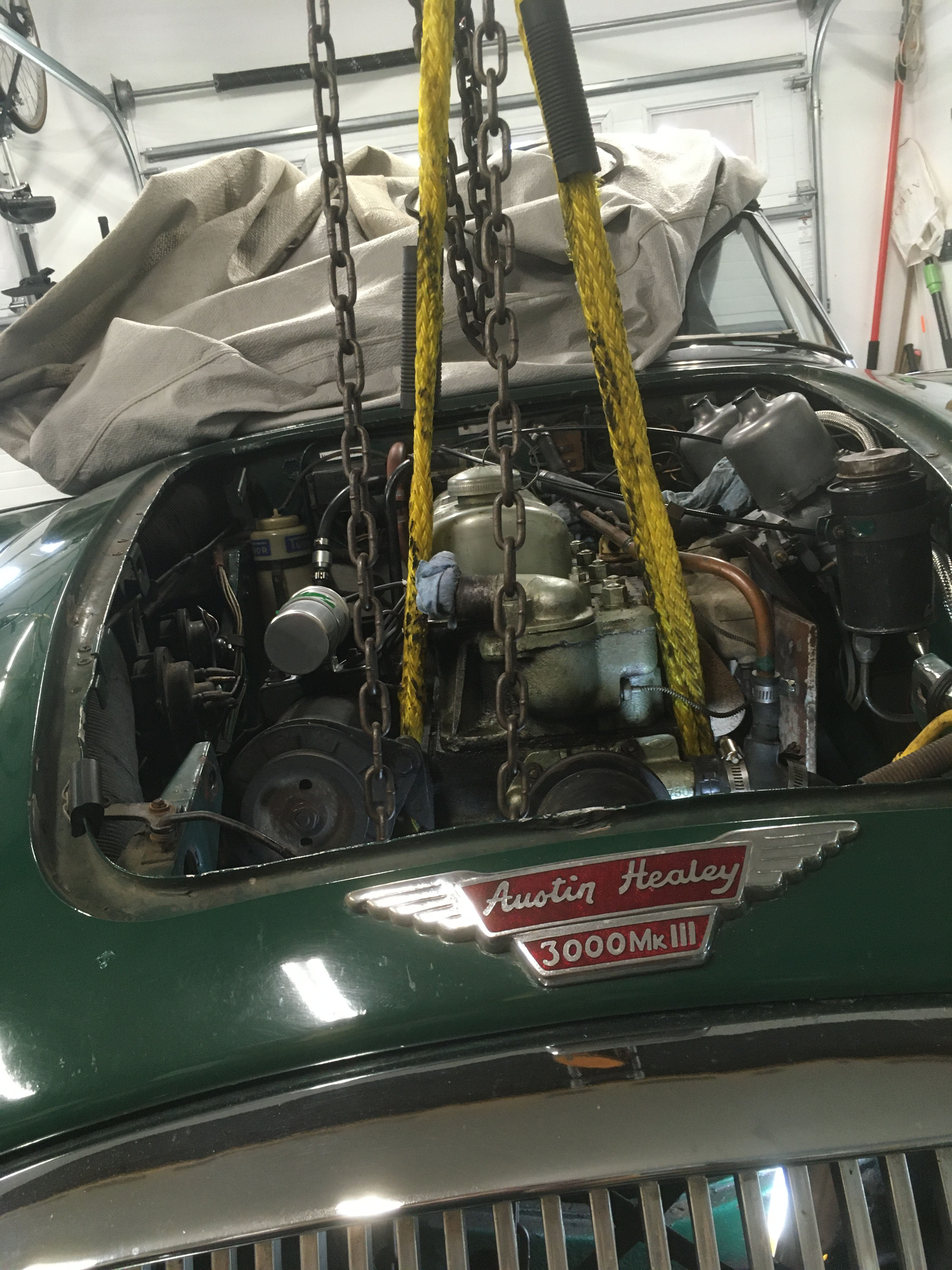

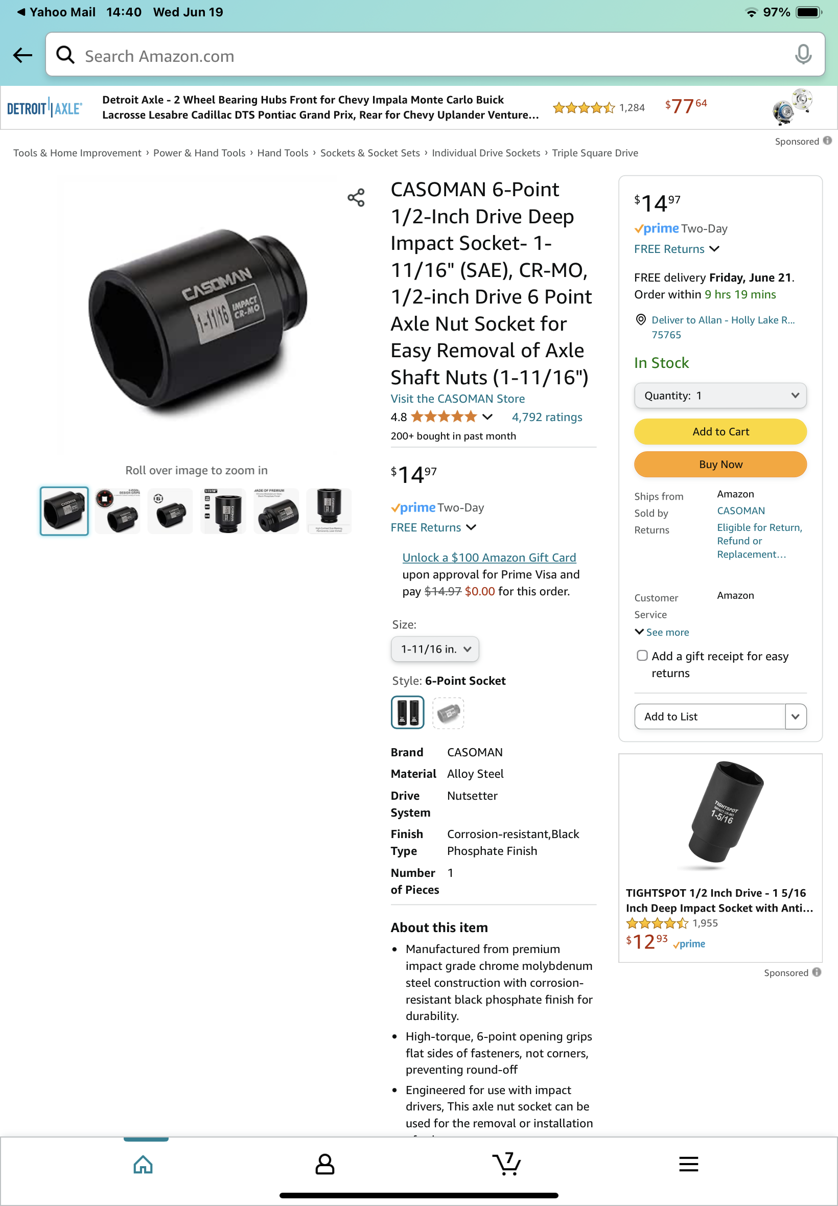

I followed the above instructions with a few variations and it worked very well on my "67 BJ8. Using a chain hoist with a thick nylon tow rope around the bottom just behind the front plate, I had to raise the front of the engine enough to get the balancer straight off. (I also disconnected the exhaust pipes to avoid stress.) The proper impact socket for the dognut can be found online for about $32. Incidentally, I would advise not to advance the two bolts from the puller so far into the balancer that they come to bear on the front cover. Once it's off, it is a good time to consider repainting the cover and check the chain tensioner. Lastly, I followed some advice to use Hylomar-M gasket sealant as it allows a very long assembly time.

Could you post a link to the impact socket for us?
1-11/16" impact socket, 1/2" drive:

I'll plead ignorance to the differences between four and six-cylinder Healey engines but why is the work that Torrey describes and pictures in post # 32 seem so much more complicated than what I experienced on my 100?
Working from under the car with the front end jacked up I was able to remove the Big Nut and timing chain cover in order to replace the timing chain and tensioner. To be sure, refitting the pulley with the chain and tensioner belt installed was not easy but I did not have to raise the front of the engine in order to remove the Big Nut.

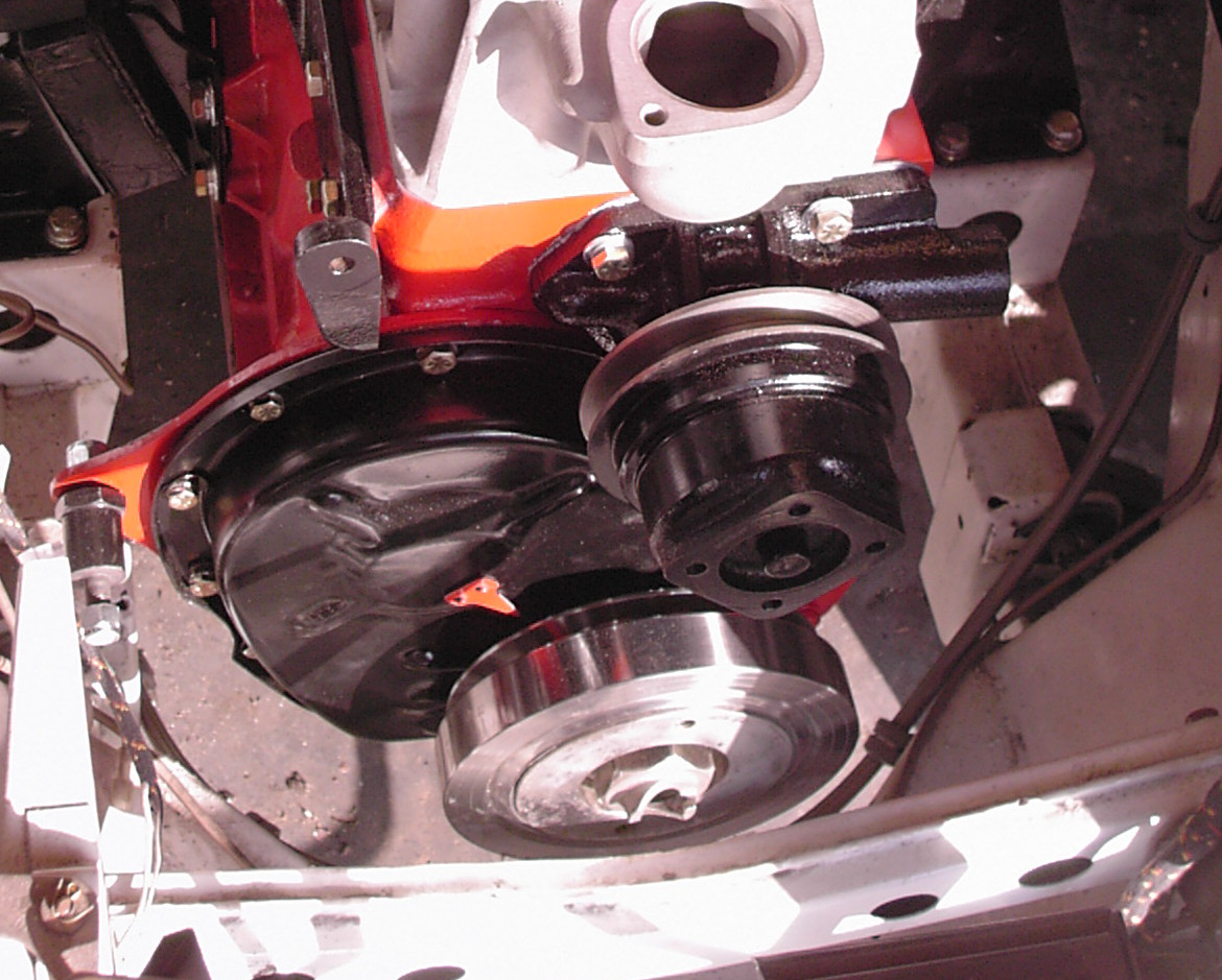

The pulley/damper hits the frame cross member before clearing the crank shaft on the longer engines.
Thanks Greg--I suspected that would be the issue. I'm fitting a damper to my engine and though I renewed the chain and tensioner belt less than 5K miles ago I will do so again before reinstallation as it would bve a bummer to have to do it again with even tighter clearances than without the damper's being fitted.
