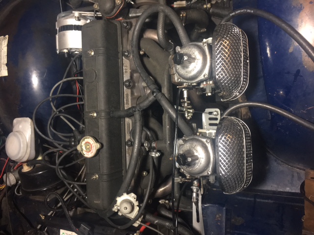

The issue I am specifically fighting is the apparent lean condition as manifested in light colored plugs (particularly on the front three) and pinging under acceleration in 3rd and 4th gear. I rebuilt the carbs myself, everything new. The temp compensators and bypass valves are eliminated. The mixture is set on each carb almost 2 turns out from full rich. The carbs are balanced and the idle hovers around 900-950RPM. Any lower than that and its not as smooth, probably due to the cam?
The distributor and vacuum advance module were purchased from British Vacuum Unit. The motor is rebuilt and has a mildly upgraded cam installed. This does result in lower vacuum readings at idle, around 11"HG. I have the timing set to 8* BTDC and the maximum advance as seen while revving the motor is somewhere around 28*(?)

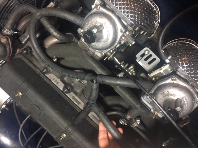

I installed an electric fuel pump and in the place of the mechanical one, installed a plate with a port to help vent the crankcase. The hose runs from this to tee into the line coming from the valve cover, and this then tees to connect to each carb, on the port above the idle mixture screws.
Just yesterday, I changed the configuration from how I had it previously; each vent location (bloc and valve cover) going to a separate carb, in the hopes that maybe one was putting out more air under pressure than the other, and leaning out the mixture of the front carbs. This seemed to help reduce the pinging under acceleration at higher speeds and shorten the time it wants to run-on, as well as stop a funny problem I had that had the idle drop when the lights were on and want to stall the motor when the fan came on. I took these changes as improvements and proof that the motor is now close generating the HP it should, particularly at idle.
If I remove the tee to open the carb ports to the atmosphere, the motor will die almost immediately. If I shut the ignition off under normal circumstances, the car wants to run-on...
Are there any ideas out there as to what could be the lynchpin in my setup? My guess is that it's something with the crankcase vapor affecting the mixture. What do the experts say?

If those are current pictures, you do not have the BVU module connected to the proper vacuum source.
You should use the nipple on the top of the rear carb and if there is a nipple on the bottom of the front carb, it should be tightly capped and sealed off.
I would also enrichen the mixture...only 1 and 1/4 counterclockwise turns from fully clockwise.
Hopefully the threads of the needle adjustment screw are still engaged with the threads of the needle carrier.
I would also eliminate the opening to the crankcase. Seal the fuel pump blanking plate hole.
You should have the valve cover "T"d to each carbs evacuation port...similar to your pictures, but without that "T" to the crankcase
Also...it looks like you have too much tension (not enough slack) in the RATCO cable.
Poolboy, I have seen your posts on many other topics, and am honored you've weighed in.
Silly me, I disconnected the line going to the dizzy right before I took the picture. The port seen on the top of the carb is where it connects to. Actually, Rob of BVU drilled it for me. Vacuum retard port is plugged off. Tomorrow, I'll reset the mixtures and plug off the crankcase vent at the fuel pump location. I'm familiar with the needles and their carriers (yuck) and know how to deal with that if they're acting up. I'll post a reply after this has been done.
Thank you!
-Erich

I was curious...what restricts the flow of gas from the crankcase into the carbs? Most cars I have dealt with use a PCV valve in the hose that limits the flow...then an overflow hose to the air cleaners for heavy acceleration when the gasses overwhelm the PCV valve. Is there a restriction on the carb connections on the TR6 to limit the gases to the carbs?
There is a plastic adapter that allows the hose from the valve cover to fit tightly on the carbs "evacuation port" nipples.
The early carbs 70 & 71 called the adapter a "restrictor". 72 thru 76 simply called "adapter" The size of the central holes are different.
'Restrictor' or 'adapter' the "evacuation ports" on the carbs open in the throat about 1 1/2" from the throttle disc.
The resulting vacuum that sucks on the valve cover (and Carbon Canister) varies with the throttle disc position.
Because of that, similar to a PCV, there is little getting sucked in when idling and more getting sucked in during high speed cruising...You can connect a vacuum gauge to the nipple and have a look at the variation.
