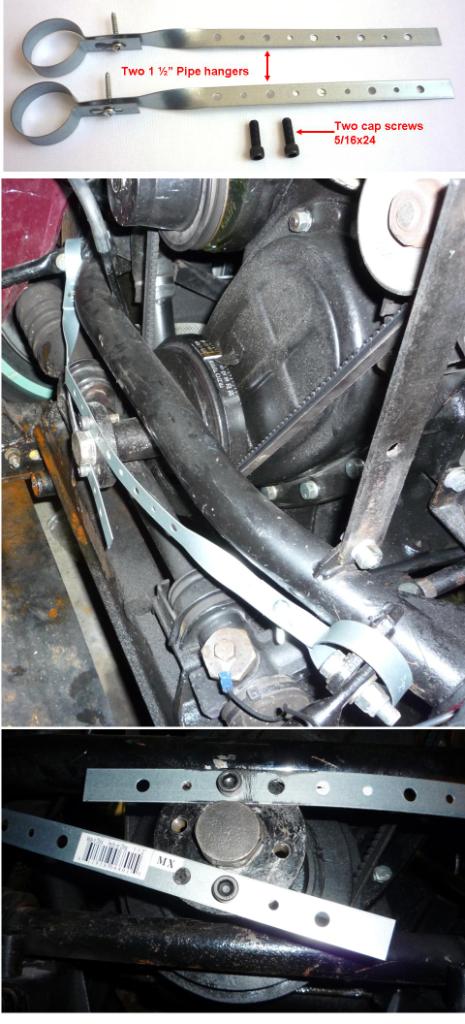

This is what I did on my TR6 and it worked great...
Thanks for the idea, I don't have the extension piece because of the electric fan but something like that might work......
Right... I figured that the engine layout was different, but the general idea could be applied. Good luck!
