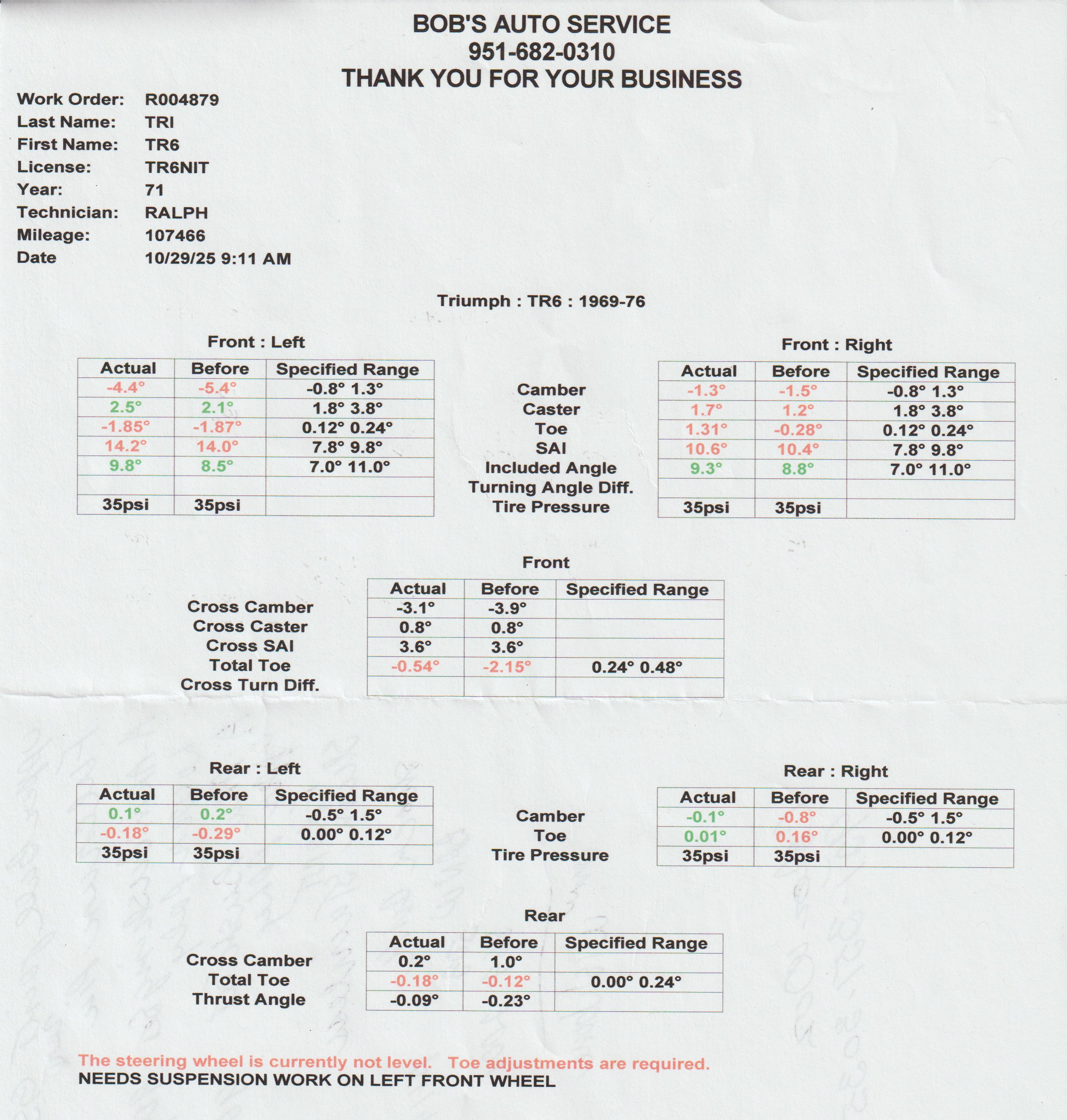

Went for 4 wheel alignment same place 2 months prior, took box of shims (1/16-1/8-3/8"
winking smiley
to help with 1 size shim from vendors. With the shims & G.P. adjustable trailing arm brackets the rears dialed in -camber. The fronts couldn't be aligned, shop was puzzled, called me into the pit, we looked at the upper/lower trailing arms & entire front suspension parts (nuts, bolts, washers, poly bushings) all seemed fine said he heard a pop when raising TR while on rack to align but couldn't duplicate sound while I was in the pit.

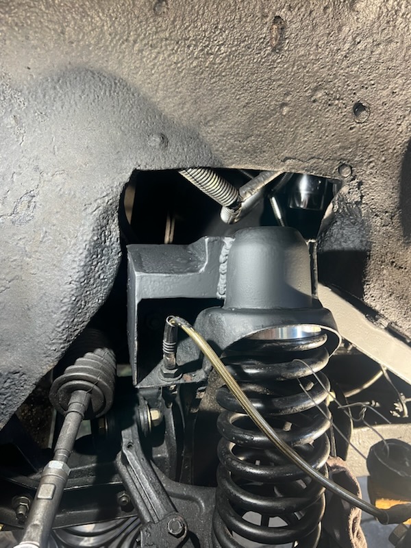

Drove home called Master British Mechanic Tracy said he'd be by @3pm got off the phone to the TR6 Cave while wheels on the ground full front end suspension inspected, further inspection above removable suspension parts passenger side looked normal, driver's side my TR6 directed my view above front suspension, where I could see torn sheet metal.

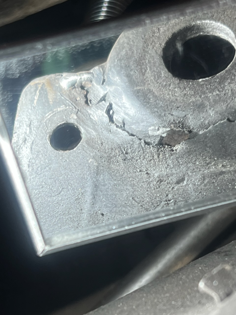

Tracy & I put eyeballs on the suspension told him I was searching to order suspension parts but can see an immediate problem. Jacked up the front end, removed the tire, there it was in plain sight, horizontal crack on sheet metal & broken weld where it's welded to shock tower (must've been what alignment shop heard pop) causing right front tire to lean in at the top

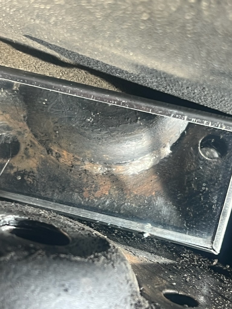

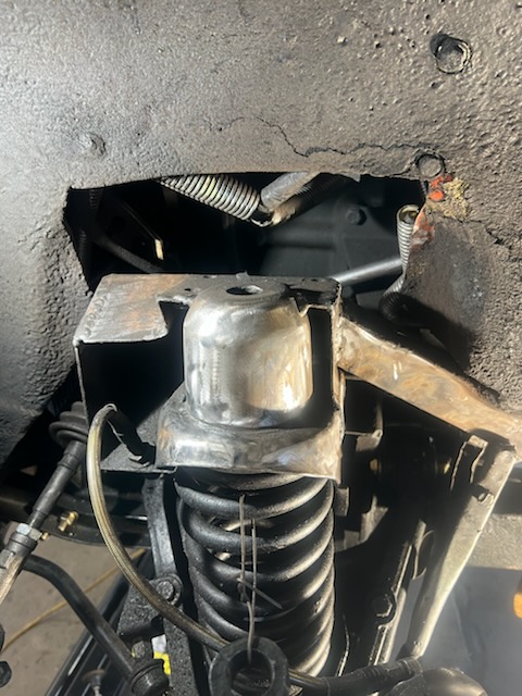

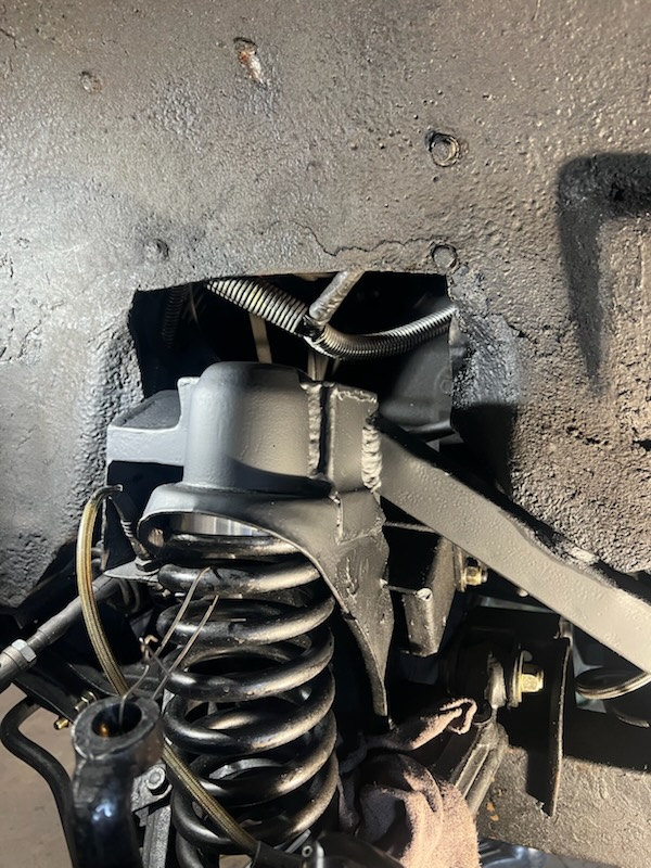

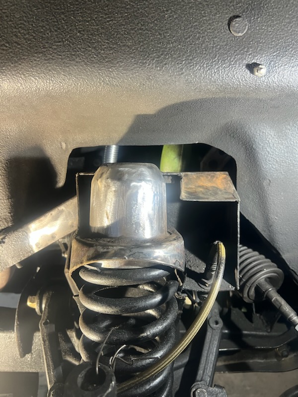

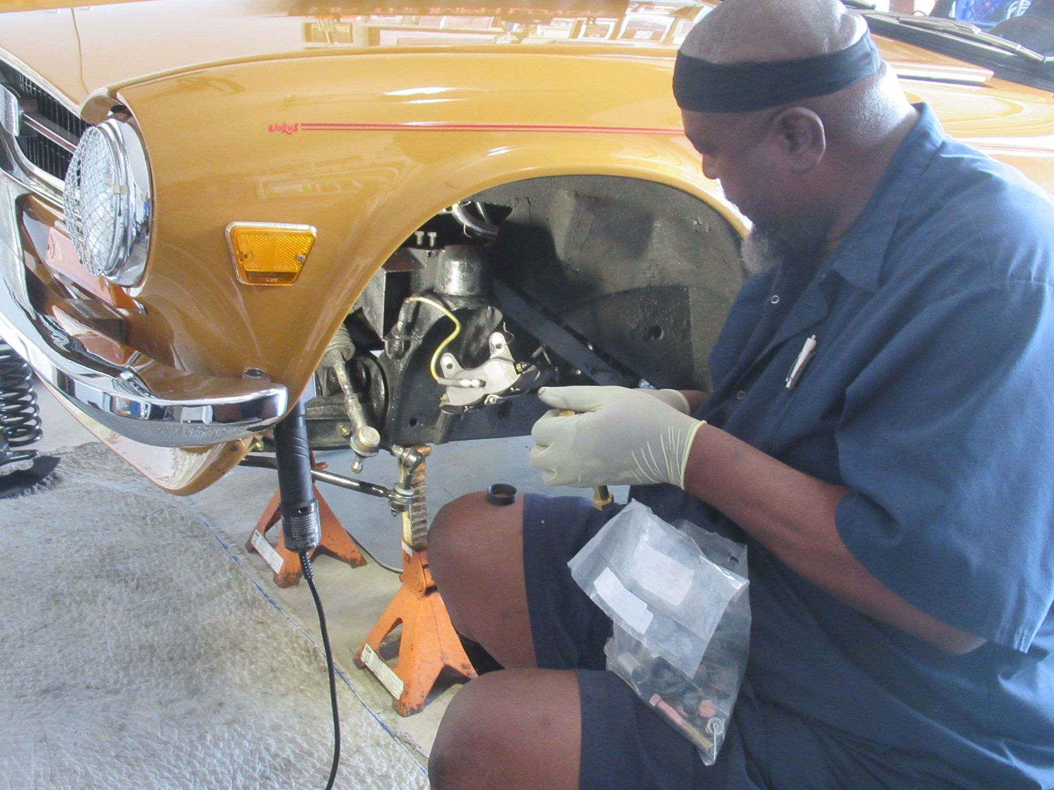

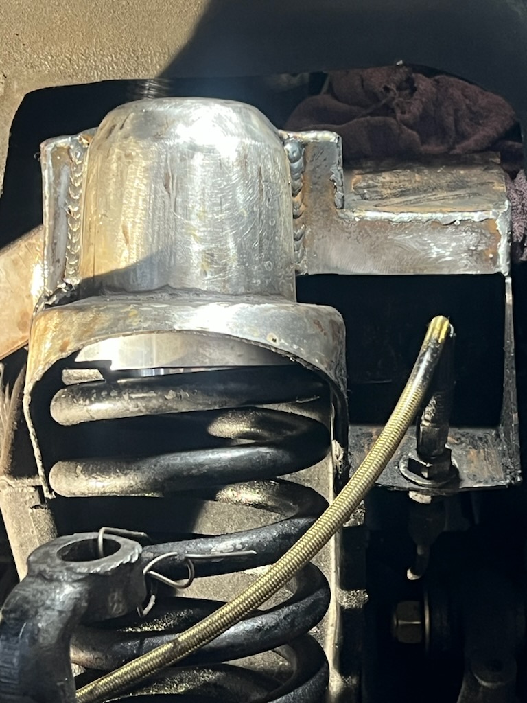

The beefed up, better than new, pro repair/weld driver's side, beef up passenger side on the damaged turret area (sheet metal to shock tower) is in final stages of completion, after alignment TR6 should be home for Xmas👏

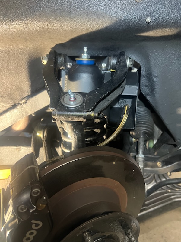

Passenger side inspected no torn sheet metal or damage, while in there beefed up same as driver's side, 4 wheel alignment, drove home yesterday before Xmas:D😁👏
Check out the mirror welds, finish project
