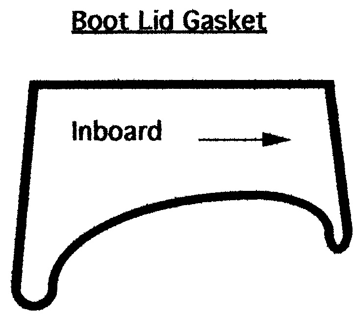

Ralph is right on. Some gaskets have a slightly different shape. I have attached a sketch to be sure.
D

Thank you Frank and Dave, Dave's attachment is the info I was looking for. The gasket that I have from moss is a different profile from the attachment but I can tell from the general shape, which way it goes. I'll also put the joint at the bottom below the handel. I'll have to try and find some of this 3M gasket adhesive. I have been using contact cement for all of the boot ( trunk ) lining. Thanks again for the info and attachment ! Ed

The important thing is to have the thin side of the strip over the inner opening flange.
"3M Super Weatherstrip Adhesive" works well. It comes in yellow or black.
