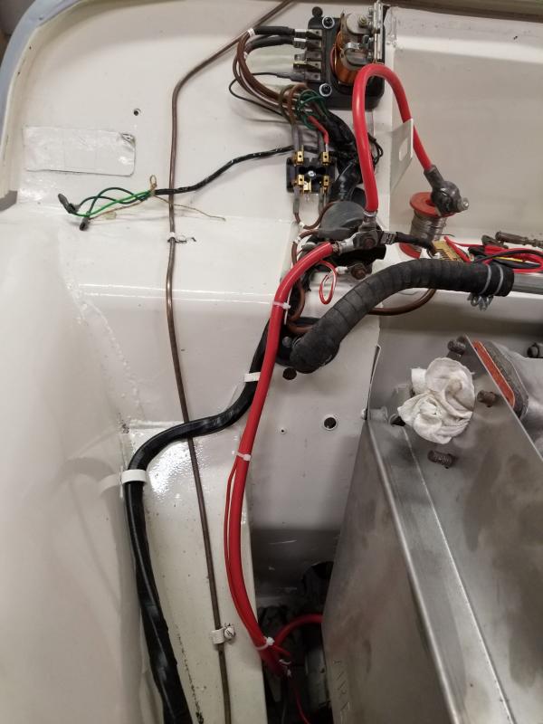

Regarding the Solenoid. I used the original solenoid contacts to energize the high torque starter solenoid so the wiring looks and works as original. The starter power is jumpered through one of the original solenoid connections. Note the small red wire tie wrapped to the main power wire.
