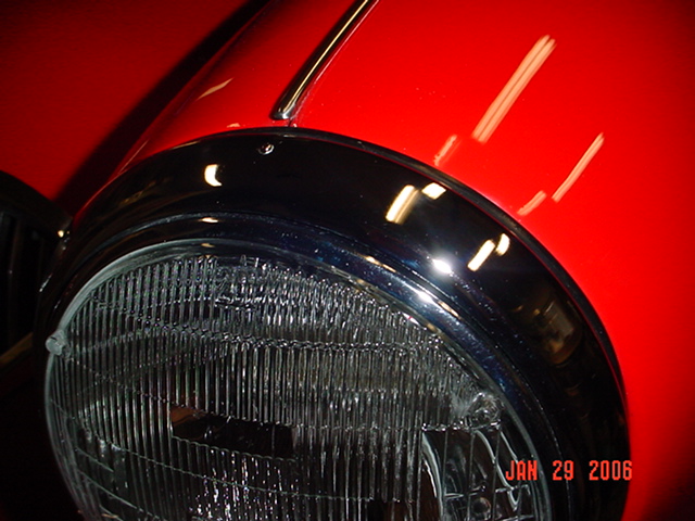

I guess I did it the hard way. At the time, the only rims I could find were from Moss. Not "quite" correct. I drilled out the pip on top of the rim & set a small chrome plated oval head rivet in the hole. The Moss rims had a very high quality plating & the rims appear to be original from the outside. See attached pic.
