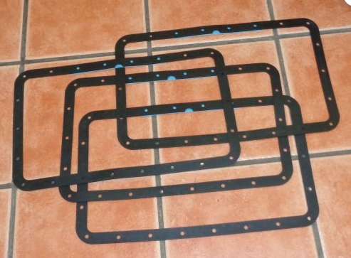

I'm currently using a nitrile rubber gasket from Tom's Toys. IMO it's a little easier to get a good seal with this one. As the guys above say, if glued, the gasket should always be glued to the movable part.
Further, make sure the lip of the pan is as flat as possible; often, a DPO has torqued the snot out of it and deformed it trying to stop a leak.
Steve, those don't look like Healey pan gaskets; they for something else? And, I just remembered, IIRC Healey pan gaskets are two-part; put some of the sealant between each joint as well.

steveg
Bob,
I copied the photo off Tom's webpage for the gaskets. Must be for 100-4s.
