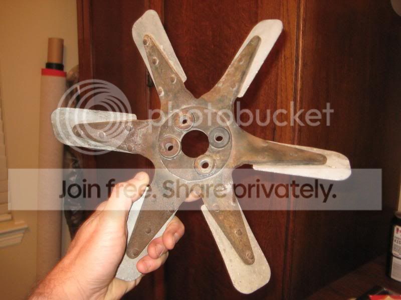

If you are in a hot climate I think I would label those 2 fans 'Not Enough' and 'Not Nearly Enough'.
The TR4 fan has more blade (which should be better) but also hangs a lot more aluminum out beyound the steel cruciform which may make that design more vulnerable to flexing, fatigue and breaking.
