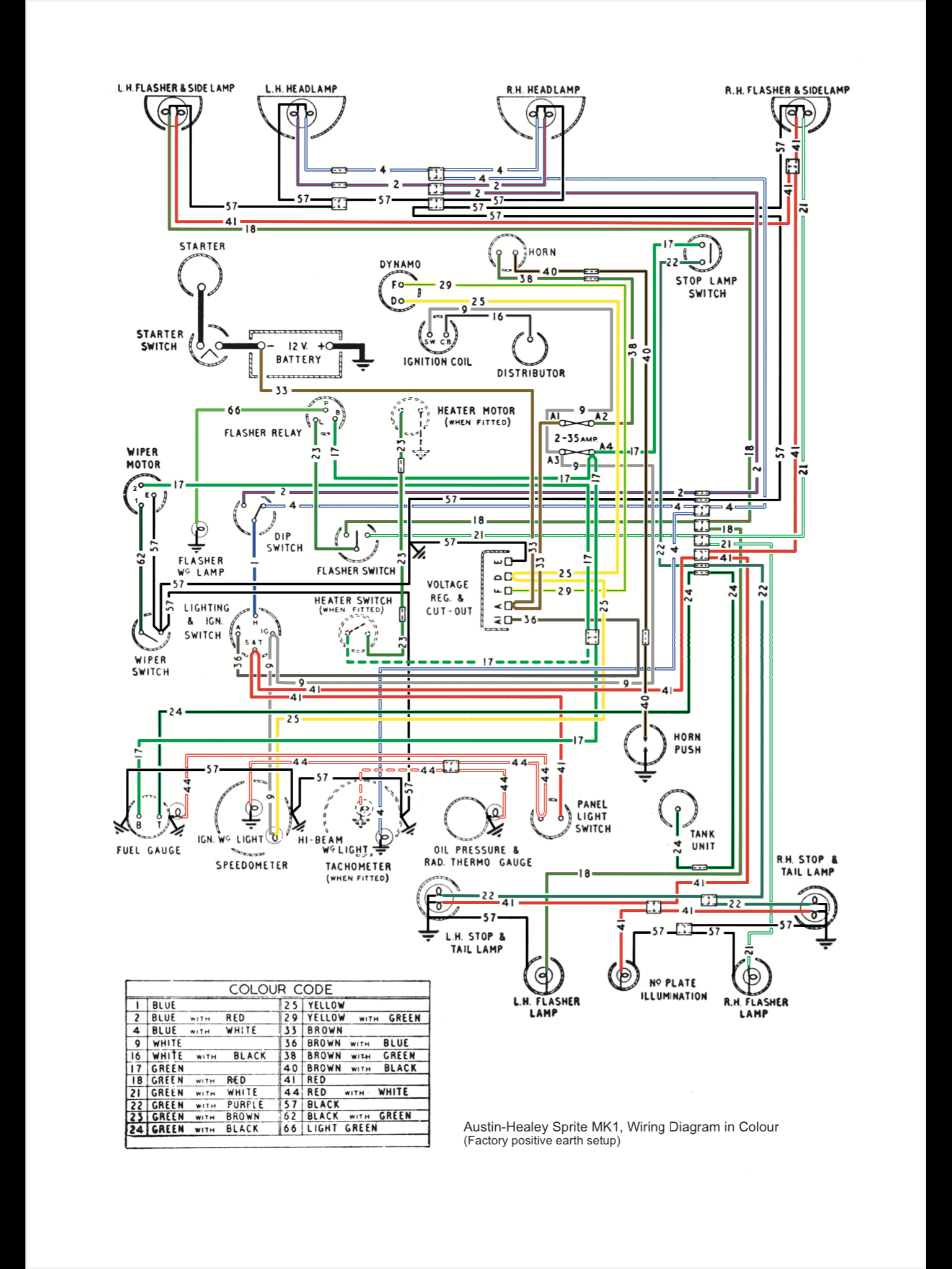

RickF
It's on the wiring diagram.

Rick. You're diagram is more complete. I have two and neither shows the item in question. I like the look of your copy. What is the source?
RickF
It's a colorized version of the factory diagram that I found on the internet somewhere.

Bayless
That's a light bulb on the diagram.
