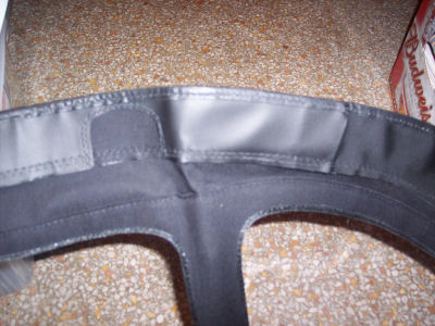

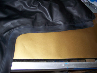

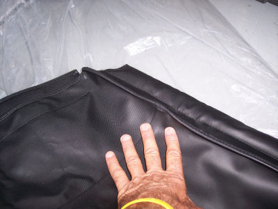

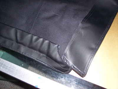

BTW, I have a brand-new-in-the-box top that I ordered for my BE but is totally wrong along the windscreen (leading) edge. I will post pictures in the hopes that with help from here I can identify what year(s) it will fit. It looks to me to be for a roll-up window car! The "flap" across the leading edge is padded!

Mike, Does the rear have the pocket for the metal bar?
Yes, Trevor, it does. It also came with a baggie containing some Tenax fasteners!! :thumbsup:

Mike, I'm not sure what that fits. :crazy:
When ever you get a top that might be right, make a quick measurement from the seam at the top of the rear bow to the 2 seams that dart in from the drivers side and the passengers side for the front bow. That is where mine is wrong and they don't want to talk about it. Over 1" difference from one side to the other. I do like the zip down rear window. My brother made a bag for the window to try to keep it in good condition.
Post your what is this top and pics in the Pub. Maybe some one will have an idea.
Well, Jack, I KNOW it is <span style="text-decoration: underline">supposed</span> to be for a Spridget (and my original order was for a '59 Sprite!), and 90% of it looks correct but it is almost as if they mixed up the patterns front to rear, the rear being for an early type car with the flat "bar" running through it and the front for a newer model that clamps to the top of the windscreen!! I may just wind up showing it and my old top to my boat-canvas guy and seeing what he can do to remedy things! It is a nicely made top even if it doen't fit anything!! :rolleyes:
