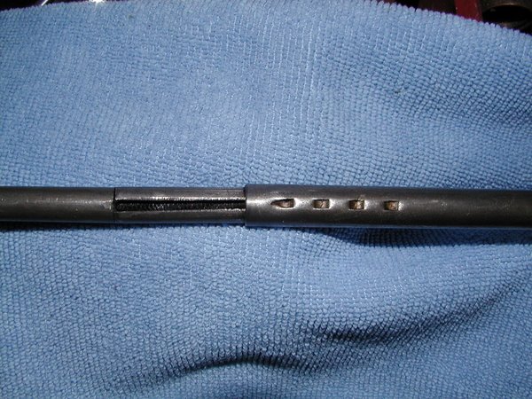

I think I may have a 'modified' adjustable. I have attached a couple of pictures.
Steve

Well Steve, I think your initial concept of trickery may be correct. :laugh:
What this looks like to me is the original nonadjustable assembly may have also had a defective stator tube.
Replacing a fixed stator tube to the horn assembly is a bit of a chore
So the[ :jester: ] cut the original stator tube off below the Horn assembly and then forced it on to an adjustable stator tube where the slot in the adjustable tube allowed the mating..---Fwiw--Keoke
