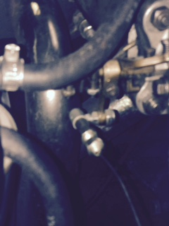

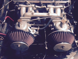

I don't know if this will help, but I did something similar. My TR-3a has the small port 4a head on it. It had the large port 3a log intake when I got it, so I put a small port 4a intake on it. I also have the H6 carbs (2nd pic). Initially, I used my TR-3a throttle linkage but the added manifold length caused it to bind. I ended up using a cable and attaching it to the center shaft that connects the carbs. I moved the throttle linkage that was on the fwd carb onto the center shaft (1st pic). It connects to the cable. The fixed end of the cable connects the air cleaners (3rd pic) and it is adjustable. The cable is a hot rod piece from Lokar. I think RATCO sells a similar setup for the TR-6 that can be adapted to a TR-4. Here are a couple of pics:

I cant help with the choke.
Good luck,
Roy

Thanks for the pics, Roy. I think maybe a cable, Ratco or Spit and some shop made parts might do it. I also studied the linkage used in TR7 when converting to HS carbs. Hadn't thought about using the Strombergs, I heard the needle selection is limited. I am going to help a friend with a TR6 tomorrow, I will look at the linkage and Bergs.
