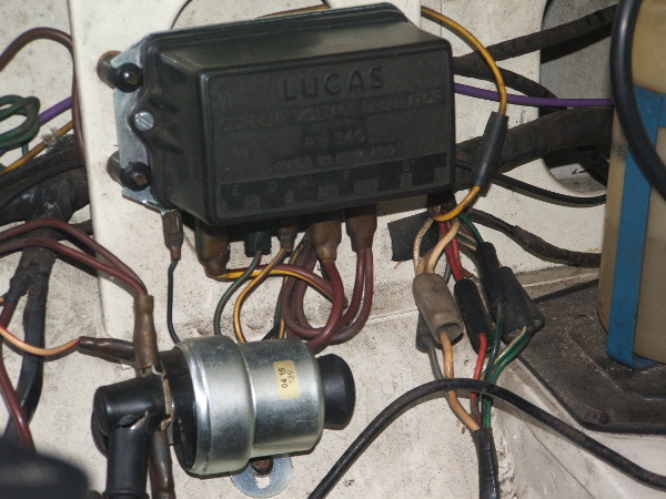

The charging system in our B is giving me fits. Put a new set of brushes in the generator a month ago, the voltage output was fine for a month. Last Wednesday the voltage dropped to battery voltage and no higher. Out with the genny, brushes looked fine, polished the commutator and reinstalled... no joy. Have a NOS regulator on the shelf, swapped out the older one, and again, no joy. Matter of fact the iggy light never went out so I assume the NOS regulator sat too long in the box and the points on the right side coil are stuck closed. Dressed the points in the original regulator, put it back in and still no charge. grrrr...

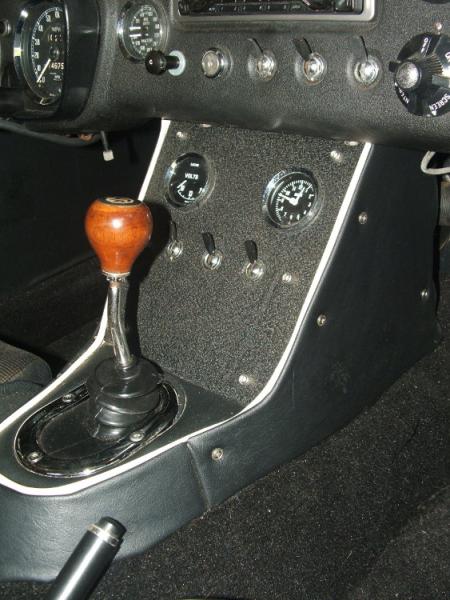

Just a voltmeter. Made up this console for it and a clock:
Thanks, guys. Saw something similar someplace on th' innerwebs, years ago. Finally got a burr under me saddle and put this one together. Still need to do a bit of "fine tuning" to make it acceptable to me. Likely a "charging port" (a.k.a cigar lighter) in there someplace.

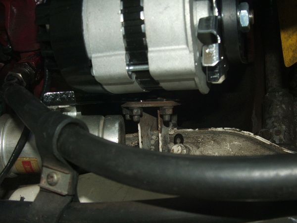

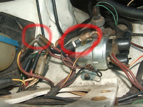

The deed is all but done. Took a couple hours at a leisurely pace. Got the rear bracket from Moss from their "conversion kit", sourced the alternator locally, the 'fake regulator' is due to be delivered later today. Did a bit of fettling with the coil mount instead of drilling more holes in the inner wing. Measured and relief cut the original bracket on the motor mount. Rerouted the wiring with a pair of male-to-male spade connectors for the indicator light/field lead, had to fab up a three-blade spade connector from some scrap bits of aluminum sheet for the three power leads. Now a reliable 14V steady electron flow. When the fake box arrives it'll take about ten minutes to put it in place. Could probably have 'converted' the real regulator but didn't want to cobble it.
The coil bracket is difficult to see, but it was cut on the band saw, parallel and even with the top of the motor mount for about three inches and angle-cut at just under a forty-five degree angle toward the coil end:
The 'bodge' with the wiring until the fake regulator gets here:
