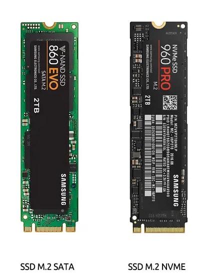

Well, I got a little more education on HP Laptop/Notebook computers! If it was built around the end of 20/20, as previously stated, HP dropped Legacy support in the Bios. What additional info I just found out was, that they also changed the connection of the hard drives to the motherboard! Even though the hard drives look "almost" identical, their not. The later drives have one slot on the connecting end whereas the previous HDs have two. The thing is, they both fit in the same slot! The computer will not recognize the earlier drive. I didn't think I was that stupid after working on these things for so many years, but realizing that I must be going blind solves the problem! :cool: :devilgrin:
One on the left fits models before 20/20 and is what I installed, one on the right is what I had to change to for the later additional HP laptop.
Good grief. How would anyone ever know about that change! The two slots would always fit in a board built for one slot. Didn't the new board come with any instructions or info on the change?
No Tom, they come in a plastic case and a price tag! :thumbsup2:To my knowledge HP never initially put that info out there, at least in the beginning. They are getting cheaper though. One I bought had instructions to make sure I was grounded before handling it!, I'll buy that. :rolleyes2:

You can fit a sata drive into an nvme slot and it will work if the motherboard was made compatible. obviously HP are not.

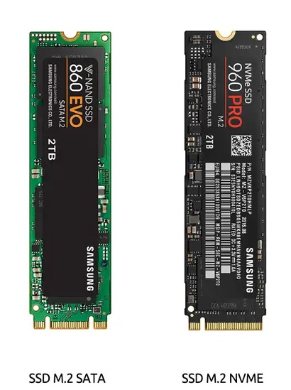

That later one on right is similar to the 2TB stick I used to make my external SSD drive, except mine is the 990 Pro. That sucker is fast!
