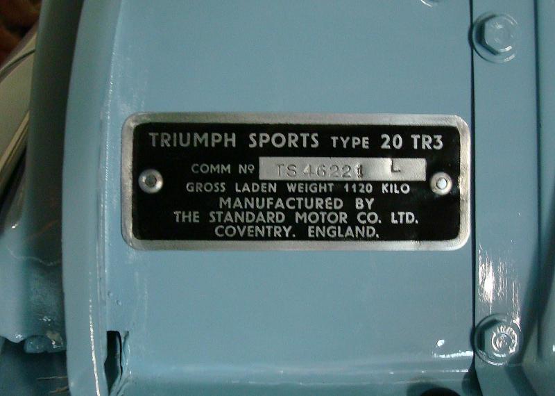

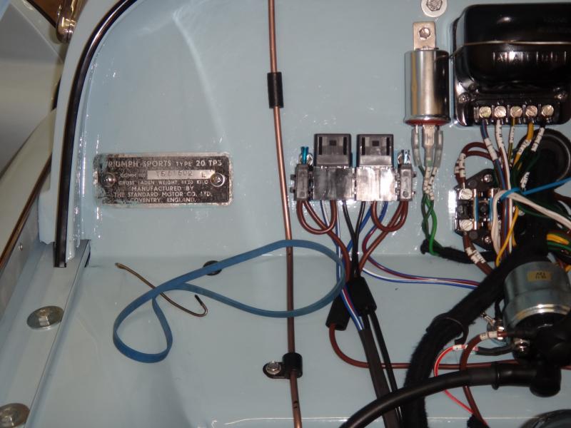

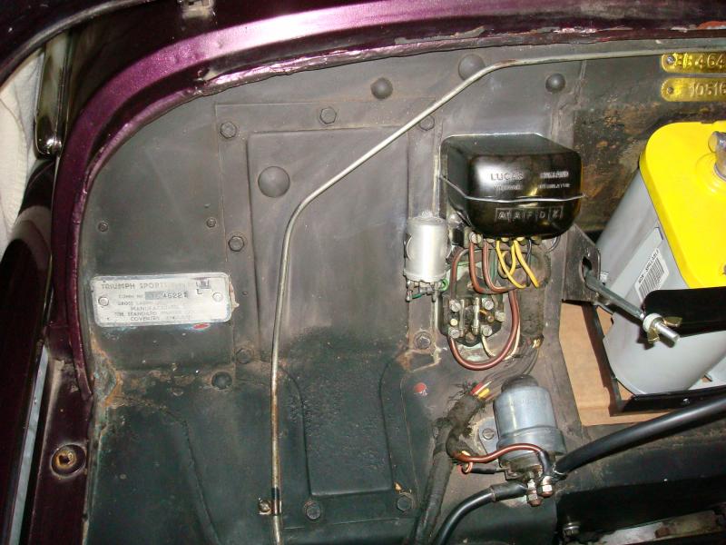

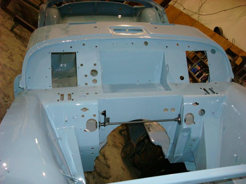

My car, TS46221L, is exactly as you have described. I suspect the extra holes ended when the blanking plate was deleted. Attached pictures are of my car before, during and after restoration. I chose to restore the original commission plate and the original rivets.

Thanks for verifying that those holes are original. As to location the holes in my car look exactly like your pictures. The only difference is that in my car the bottom left hole does not look as if it were done professionally. It is deeply punched into the sheet metal. But then these plates were never intended to be removed, so who was to see the hole beneath it.

And the world has one less purple TR3A.
Nice work on the rivets - were those a special (aircraft?) item - they look quite original with the solid center.
Yep, the rivets were fun. I couldn't find anything that matched the original. Mark Macy gave me the solution. From the local hardware store get a large rivet that has the same size center pin as the original. Turn the head down to match the original rivet. I used a small metal lathe, but a drill press and emery cloth work fine. Install, but don't break the center pin. I cut the pin and filed the end flat. Take a punch and tap it flush with the rivet head. I enjoy the details!
