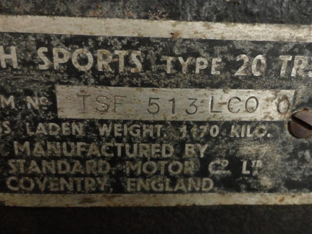

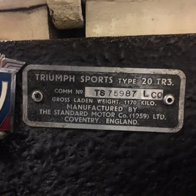

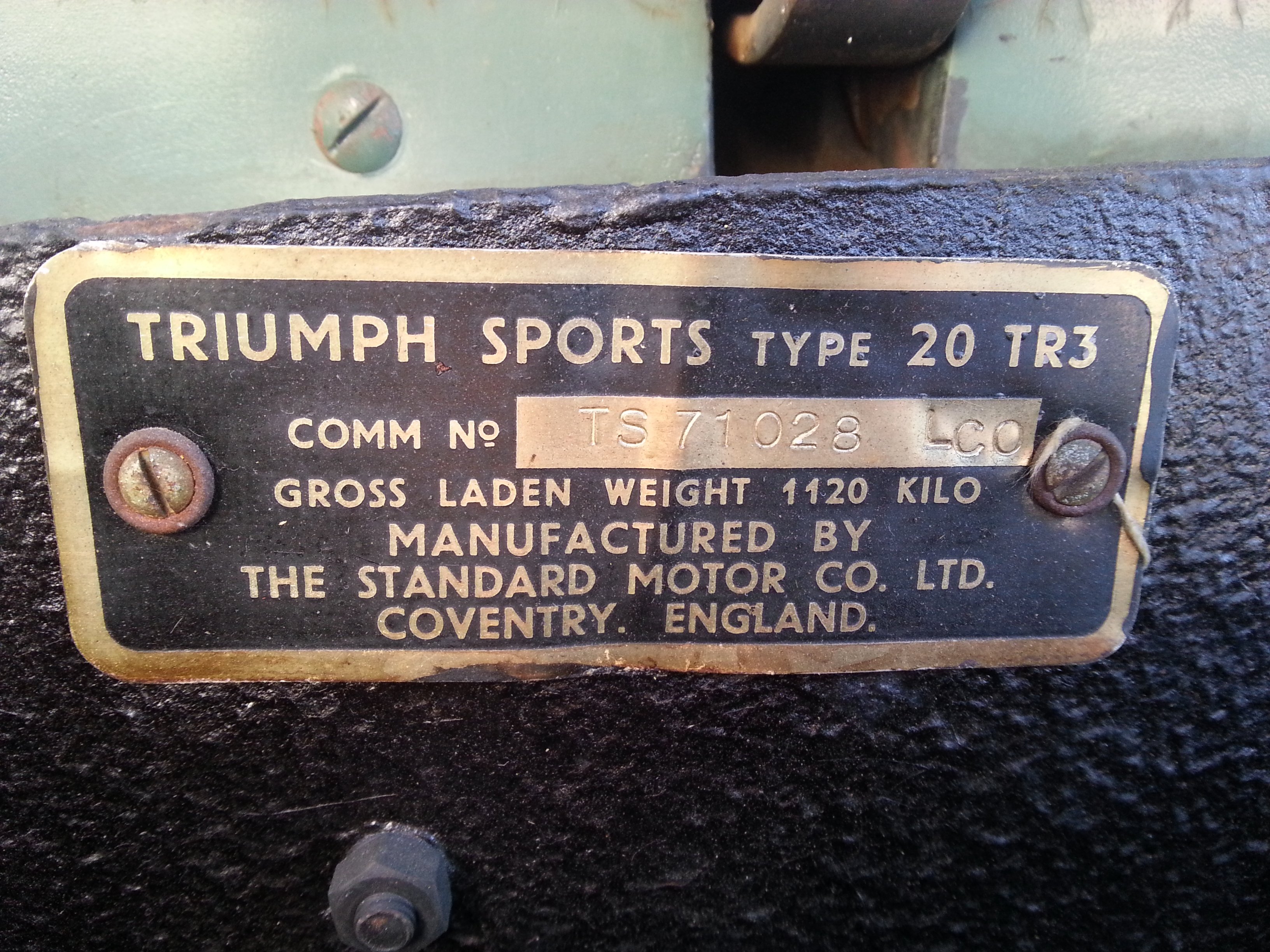

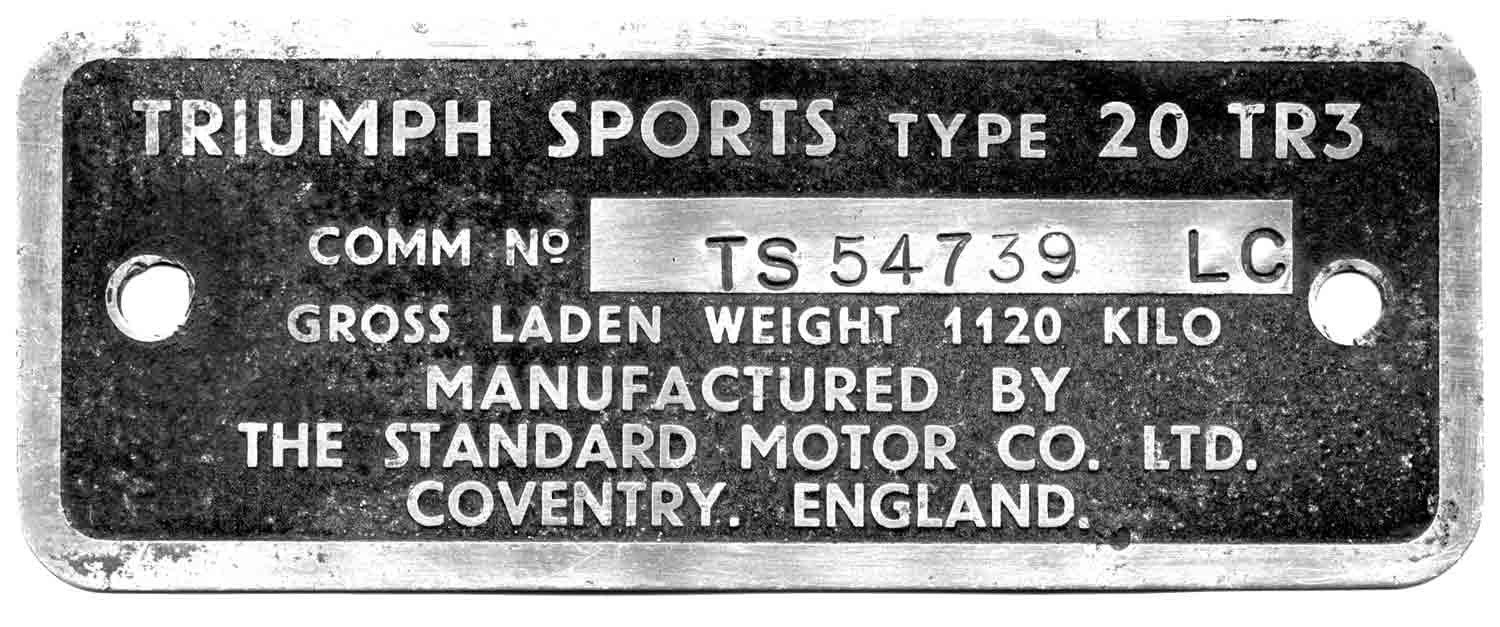

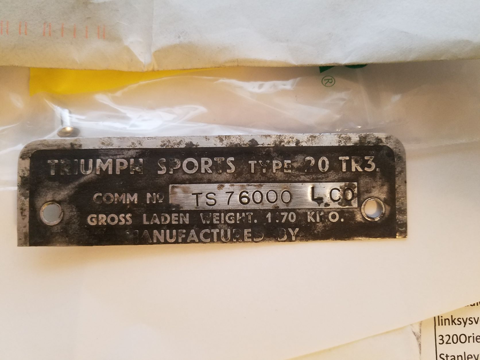

For the Italia, there were three variations of the Commission Plate. One said 1120 KILO (no period). One said 1170 KILO. (with period) and has (1959) in the manufactured line. The third has the same 1170 KILO. but has abbreviations in the CO. and LTD. (TSF cars)

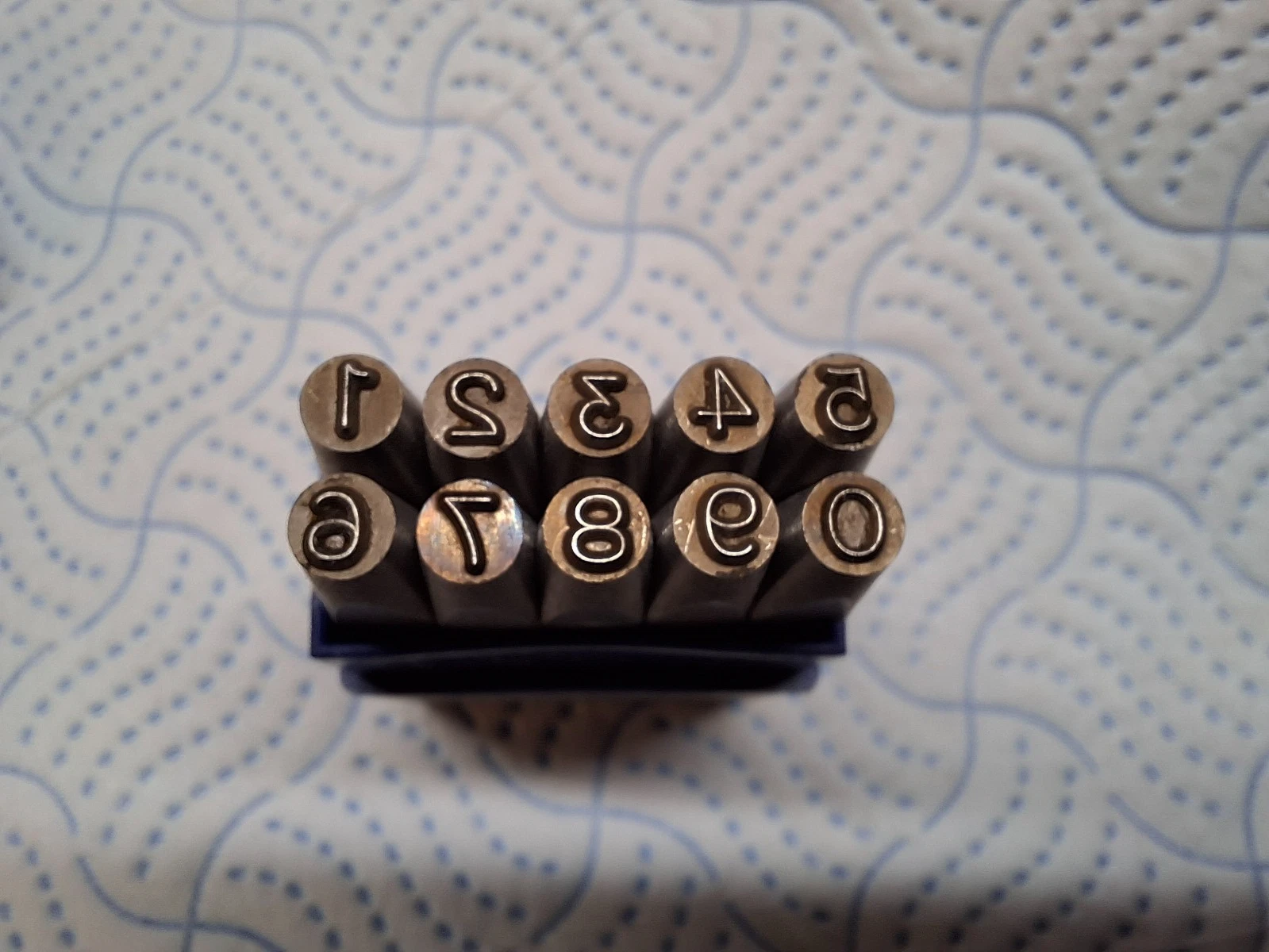

The font for the letters and numbers is the problem. We can have the plates properly etched and blanks made. We need the steel stamps to stamp the numbers and letters on the blank plates. The font is unusual and the height is odd. I found a set of stamps on ebay that had the correct font, numbers only. A vintage set made by Imperial in the UK. Here is a pic. it has long top on 1, also no bottom on 1. 3 is flat top. 4 is closed. 5 has curved top. 7 has curved diagonal (not unusual).
