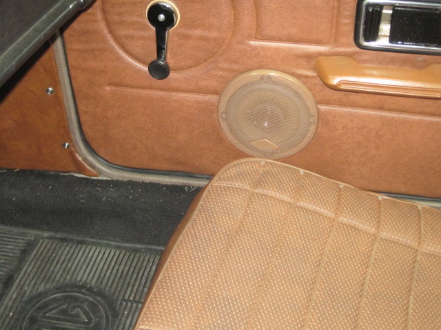

In case anyone else is considering using this product, here's my experience. First, here's the "before" pic. You can see the original beige door seals - and how noticeable they are next to the Autumn Leaf panels. Also notice that the fiber washer between the window winder and the door panel is beige as well. The aftermarket speaker grilles are some color of Krylon paint - the closest I could match the panels with rattle can paint I could find locally. That part wasn't too bad - but it isn't right. Still, it was better than the big, black grilles.

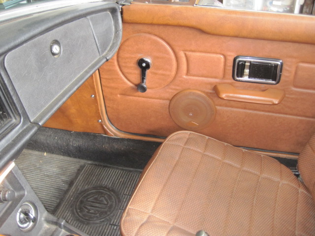

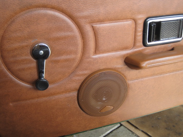

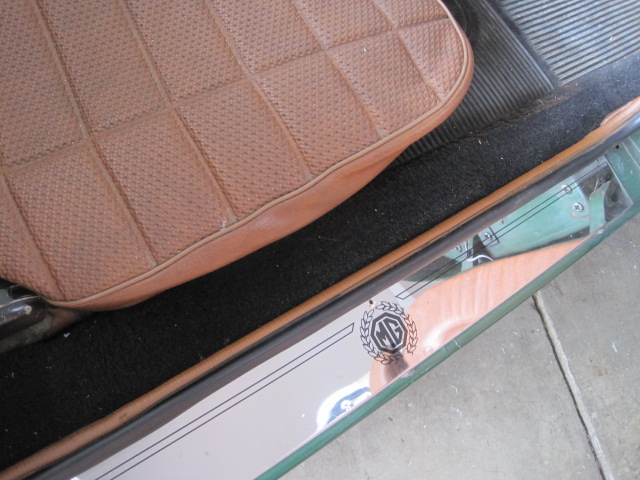

Next, I tackled the more difficult part - the door seals. I started removing them, but then became concerned that just removing and replacing them would ruin these 38 year old seals...so I decided to mask them and paint them in place. I think I made the right choice. The end result came out just fine, the masking probably didn't take any longer than removing and replacing the seals - and I didn't screw them up!
The masking was accomplished mostly with duct tape (which stuck to the rubber where the masking tape wouldn't) and aluminum foil (my favorite masking product). I pulled the kick panels away from the seal to allow better access to paint the edges. I'm really, really happy with the results. So is my wife. :) Here's a couple of pics of the result. It looks even better in person than in the pics.
