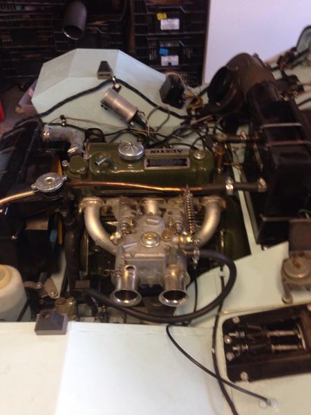

My Christmas present that I purchased for my self 4 months ago was installed yesterday with the help of my Uncle from Holland. From now on he will be called the Carb Whisper. Out the box the carb drives the 948 better than the old HS1 ever did. I still have to install the fuel regulator, but so far I am ecstatic! Now I want to dial it in before I move on to other mods (Datsun 5 speed, disc brakes, etc..) So more questions.......
1. My dissy has a vacuum advance. There is no place to hook up a vacuum advance on my Weber 40 dcoe. I have done some reading and a balance tube ( like that on the stock intake manifold) seems to reduce the Coanda effect on Weber intakes and is a possible attachment site for the vacuum advance. What my question is what size tube? My manifold has 2 ports which can be used for a balanced tube. I have read that a smaller tube will have less fluctuation than a larger tube. The larger tube reduces the Coanda effect to a greater degree allowing fuel to flow more evenly to the cylinders.
If the mod does not help I can always go to a mechanical sissy, but $$$$$$$.
2. What air filter(s) would you recommend? I am using 2 inch stacks and have about 3 more inches of clearance.
3. How do I vent the rocker cover without an attachment to the air filters? The 948 at speed requires a slight vacuum at the rocker to keep the motor from leaking.
Regards
Paul

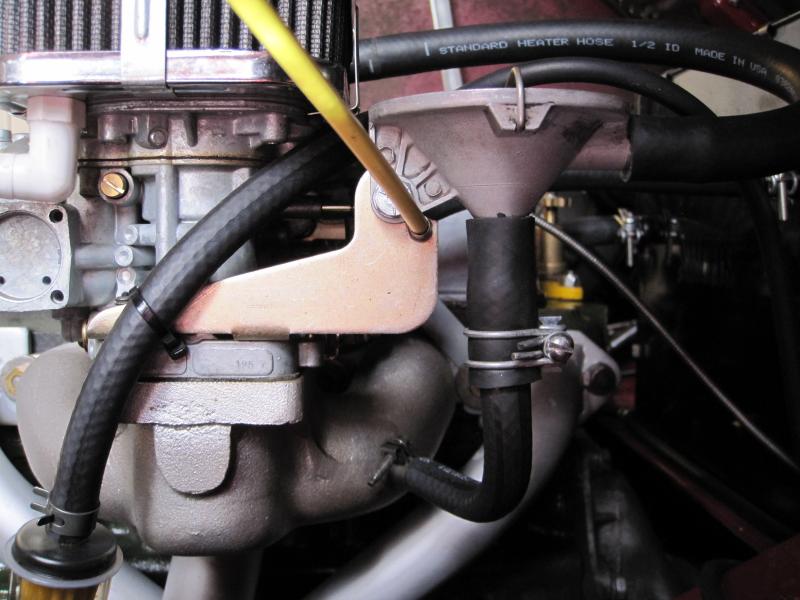

I'm not sure how well venting via the air cleaner would be as far as providing enough vacuum for the scroll seal, but here is how I suggested someone do it with a DGV, and he reported it worked extremely well. He nor I never found the vacuum from an air cleaner connection to work that well alone. If your air cleaner solution tunes out not to be sufficient, you could resort to this. I suggested he restrict the orifice to 9/64".
Kurt & Gerard

If I were doing your set up I believe I would go to some type of oil separator from the tappet cover then to a restricted orifice and PCV valve [essentially just a check valve] and that to manifold vacuum. Then I would put also put a tube from the valve cover to the air cleaner. I set my Datsun engined midget up that way but used a cheap auto parts little air cleaner on the valve cover vent tube. I am now getting the smell of engine blow by in the **** pit after hard acceleration so will be hooking that up to the air cleaner. I've gotten rid of the PCV and orifice and am using the take off tube on the HS6 carb now instead. I was getting the same blow by smell with the PCV and now realize that instead of just reringing this engine I should have rebored.
The DCOE has separate runners for each port so perhaps a Y tube to a nipple on each port would work or I suppose you could try the draft tube and valve cover vent. If you are going to fit a balance tube that would be an ideal place to plumb the PCV to. I guess maybe the vac advance as well. I have a DCOE set up for a Datsun engine and have avoided fitting it just yet because of the headaches you are encountering. When I do fit it I most likely will not worry about vac advance and haven't got round to the crankcase venting problem.
