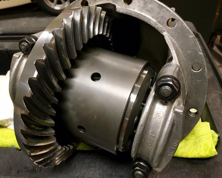

I only run Quaife Helical LSD in my vintage racer, I have 3 diffs all set-up with differnt ratios for specific tracks. The clutch type LSD, although more economical, take a lot of testing and adjustments to get them right. The Quaife is a bolt-on and go and never need to adjust or rebuilt.
True but the transx is a good diff despite needing set up. If I get an unexpected windfall maybe I'll change it. But for now I'll work with what I have. Annoying that in my 911 R replica one of these works perfectly first time albeit a bit noisy in operation which I don't mind.
