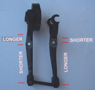

Jack, here is a picture of a rib-case vs. a smooth-case it it is of any help!

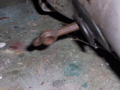

You did notice that the smooth-case one in my pic. is bent! I do not think it is supposed to be!! I have a spare smoothcase tranny that has a quite different-looking fork on it in that the slave end on it has a loop instead of the clevis-pin set-up!! Have any of you seen this before? Could this be out of something other than a Spridget?

Did not notice it was bent till you pointed it out. It really happens now I can see, it's not old wives tail. Seems like it is bent the wrong way from how the pressure would be applied. No clue but it surely looks bent.
Guess I best find a good one just to be sure.
Maybe got bent laying around the garage? They do tend to stick out begging to be snagged and bumped into, no?
