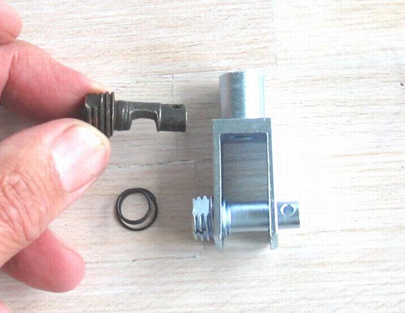

Tom - Before you go inside the bellhousing look at the front end of the clutch master cylinder. I had the same problem when I was at the Triumph races at Virginia International Speedway in June 2004. I found the problem. Look at the photo. Maybe you have the same problem.

Don - I'll take a look at that this morning. Thanks for the picture. Sure hope that's the problem. As a tangent to this, only the clutch m/c has that spring. The brake m/c doesn't have the spring. Is that right?

The brake master cylinder clevis pin has that spring washer as well.

Per Don's suggestion I took a look at the clevis pin(s) at the m/c's.
There were no springs, no washers, the pins weren't screwed in the shackle at all ("loose" in the holes), and the cotter pin leg on the clutch side was - I think - getting caught on the mount bolt. The clevis pins showed no obvious evidence of wear (compared to Don's picture), so I've kept them in.
So I found some small springs and put them on the pins between the head side of the shackle and the pedal connector, screwed the pins in as far as they go, and replaced the cotter pins, bending the legs so they were around the pin and not dragging on that bolt head.
I'm assuming those clevis pins are screwed into the shackles as far as possible, right?
