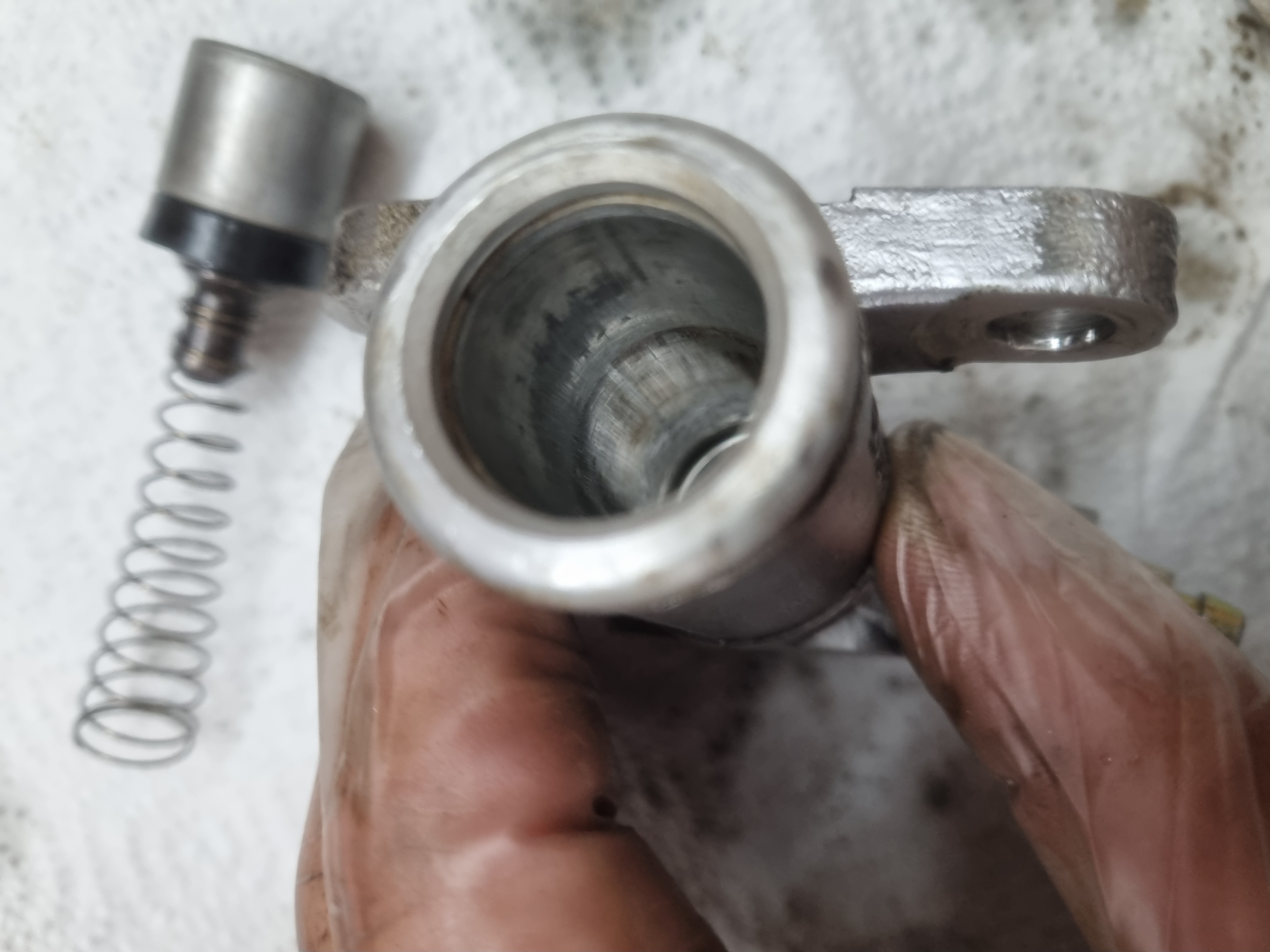

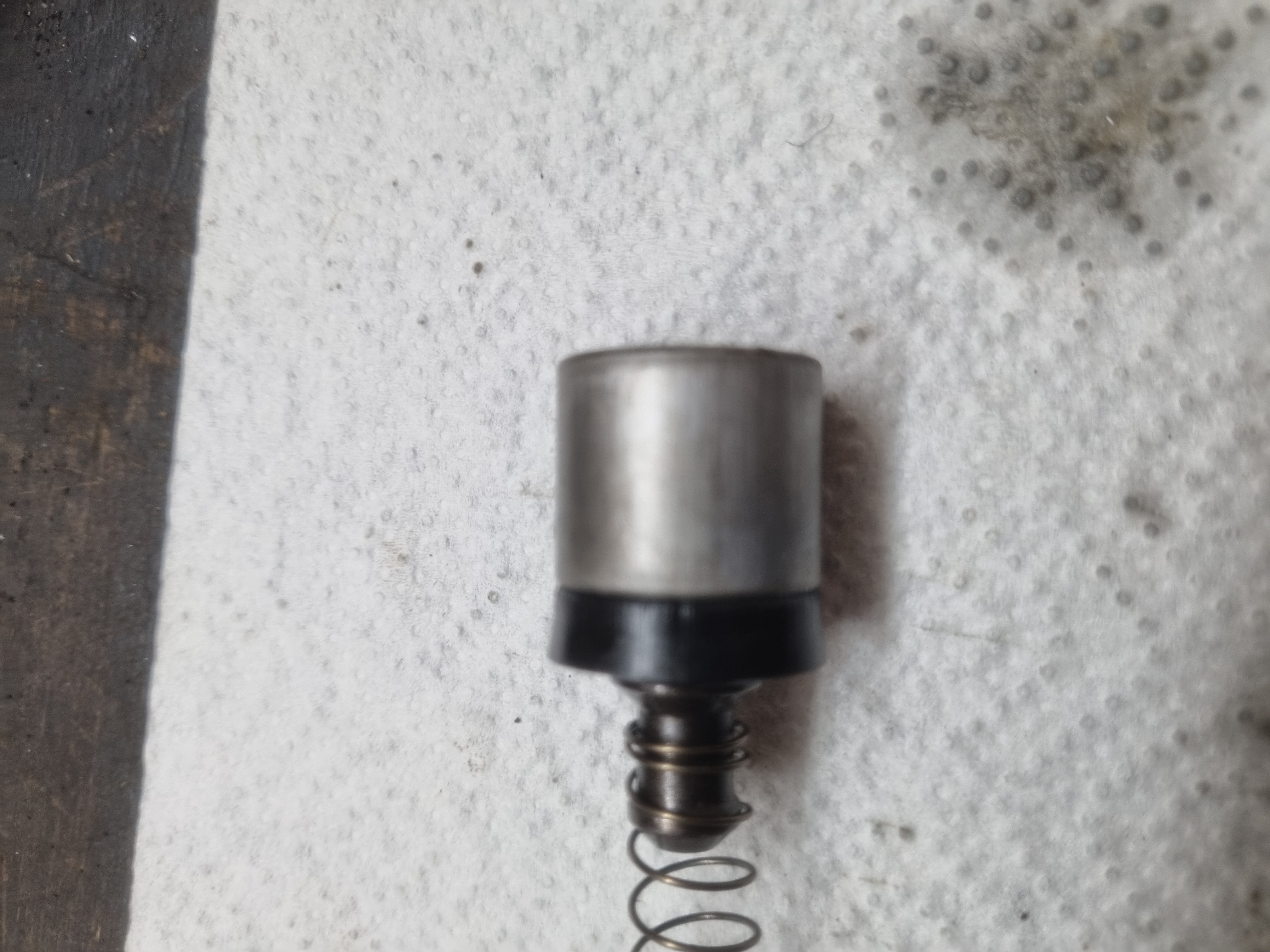

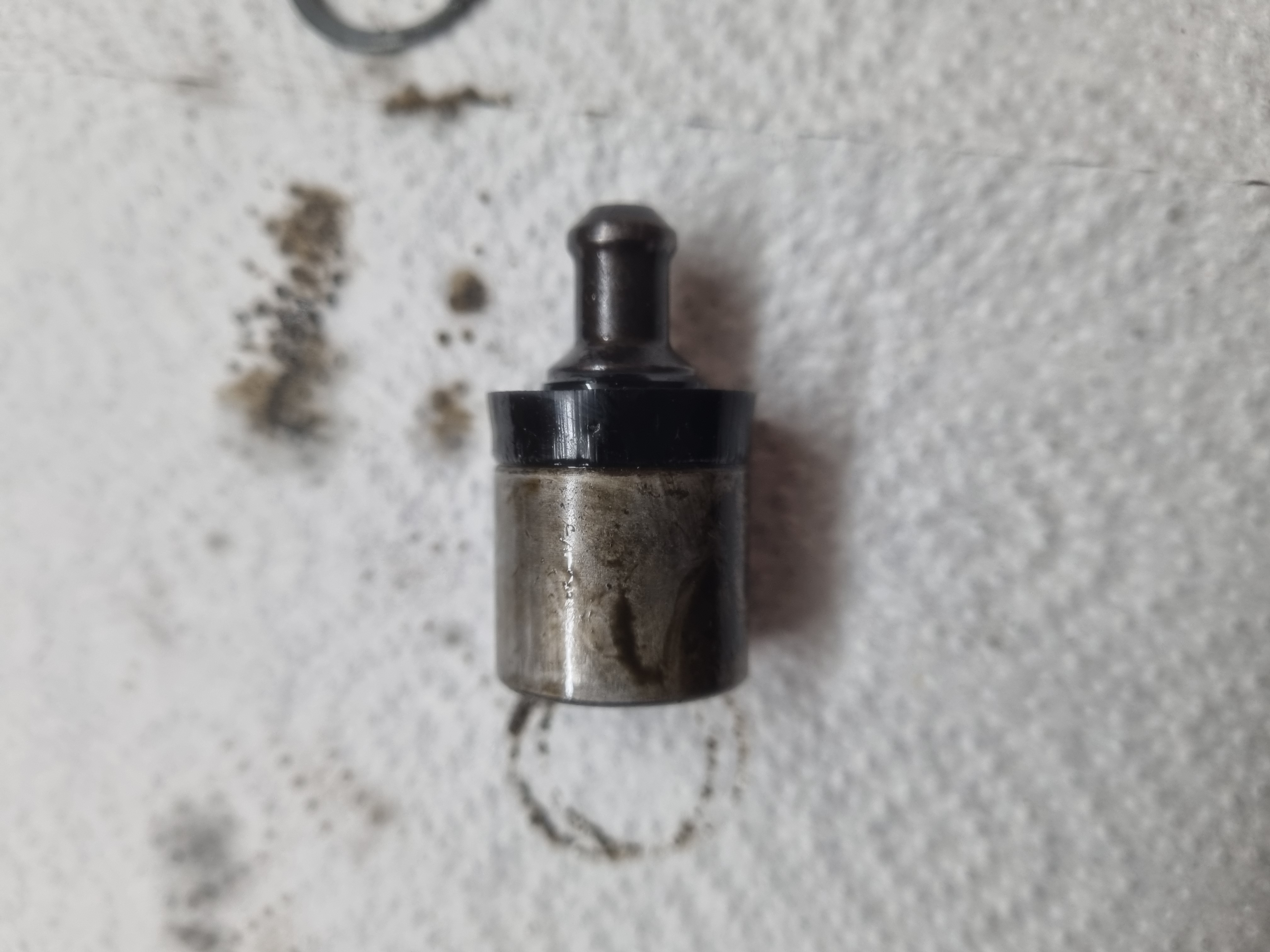

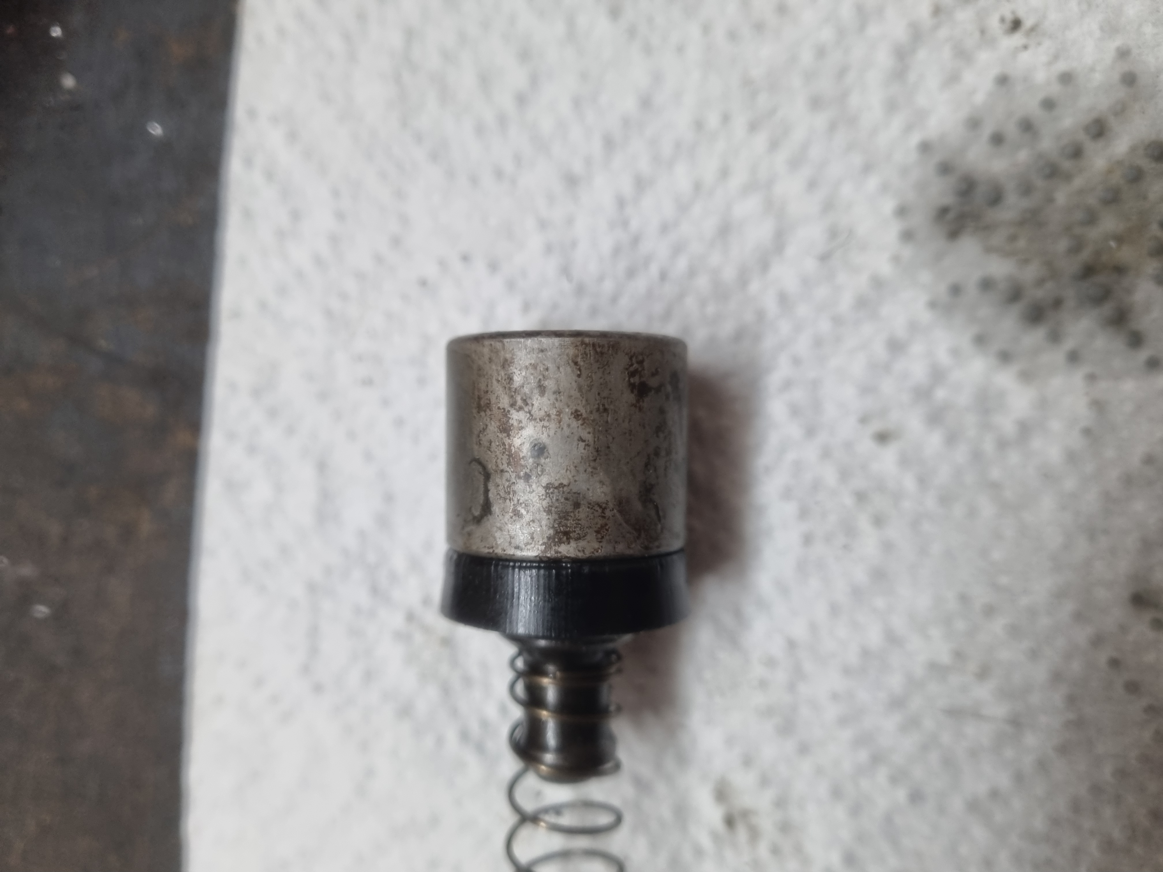

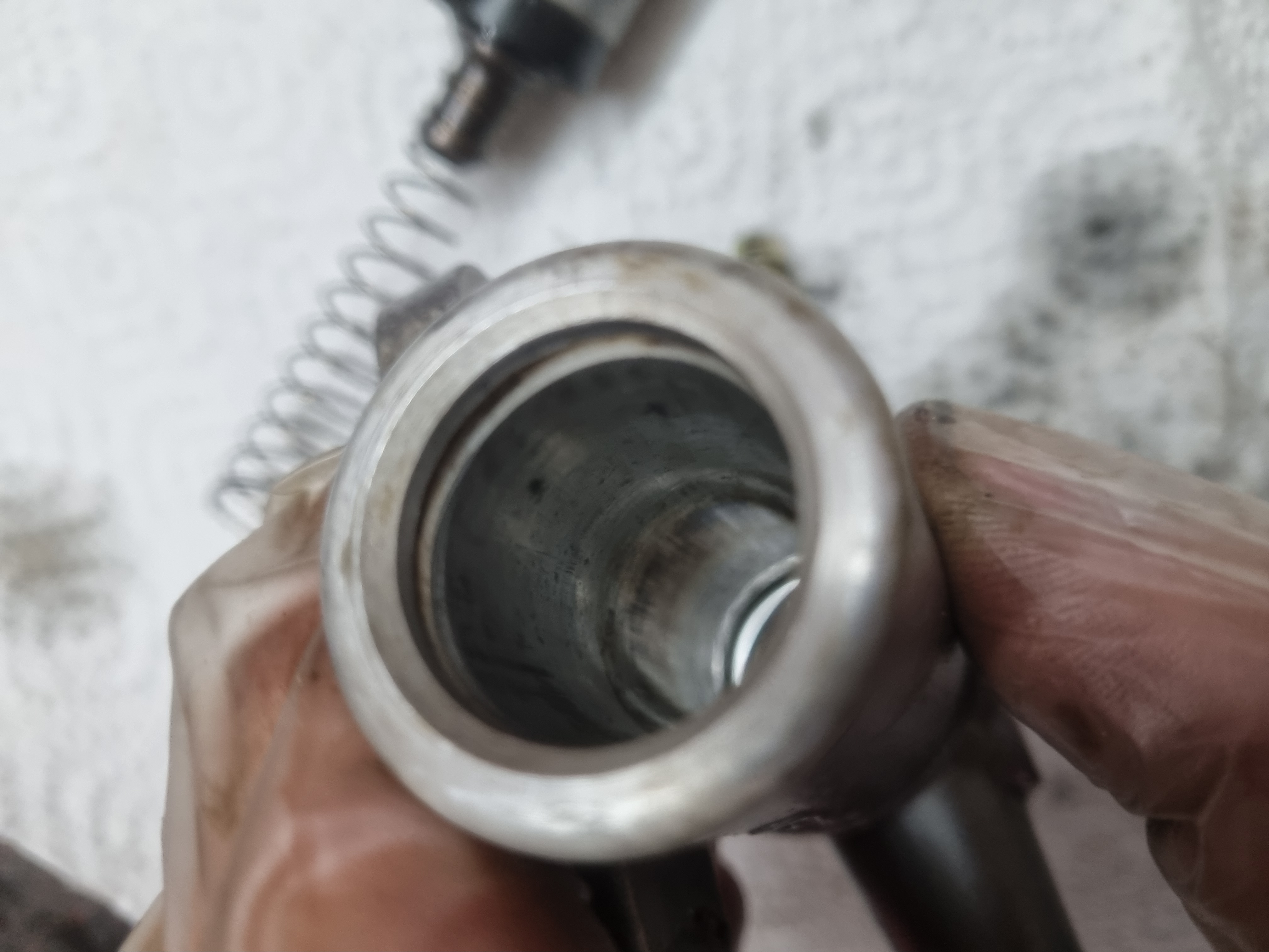

Instead of the video I post a view fotos of the ineterior of the slave cylinder.
Maybe smebody can tell me if I better would replace it or still can use it. Of course all seals will be replaced.

I (personally) would re-sleeve or replace the cylinder; some say they can be honed, some say no way (the piston can be cleaned up). But, it's not likely the pitting is the problem; it will eventually cause leaks past the seals. Greg's suggestion of the flexible line causing the problem is the most likely. If your car happens to have the original brake and clutch flex lines they should all be replaced.

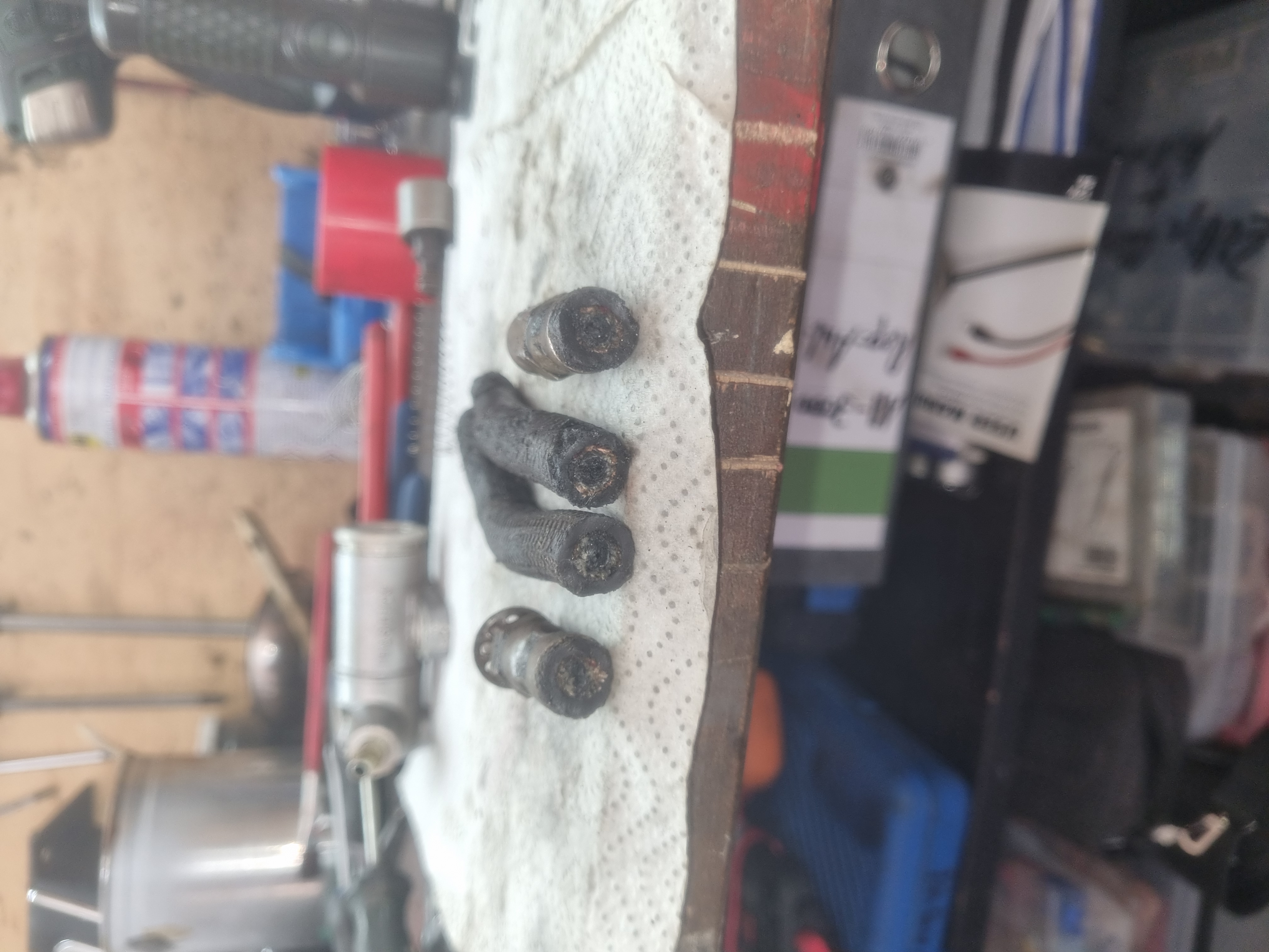

I think I have found the main problem for the slow clutch engagement. It's probably the flex hose that is connected to the slave cylinder, which seems to be the original. So Greg seems to be right. There is still a tiny pin-sized opening that you can't see on the photos, but that's not enough to allow brake fluid to pass through fastly when engaging the clutch (almost no backflow). Therefore, the clutch fork only moves very slowly. But I won't finally know until the new flex hose and the two cylinders are here. I will report again then.
I have cut the hose into 4 pieces to find out where it is clogged. The complete hose is swallen and almost clogged.
Since I have now finished the replacement of the clutch, and the main and slave cylinders as well as the flex hose, the clutch is now working better than ever before. The reason for the clutch not always engaging was definitely the flex hose which was almost blocked. The clutch fork is moving now very fast as it should. So, that's it!
