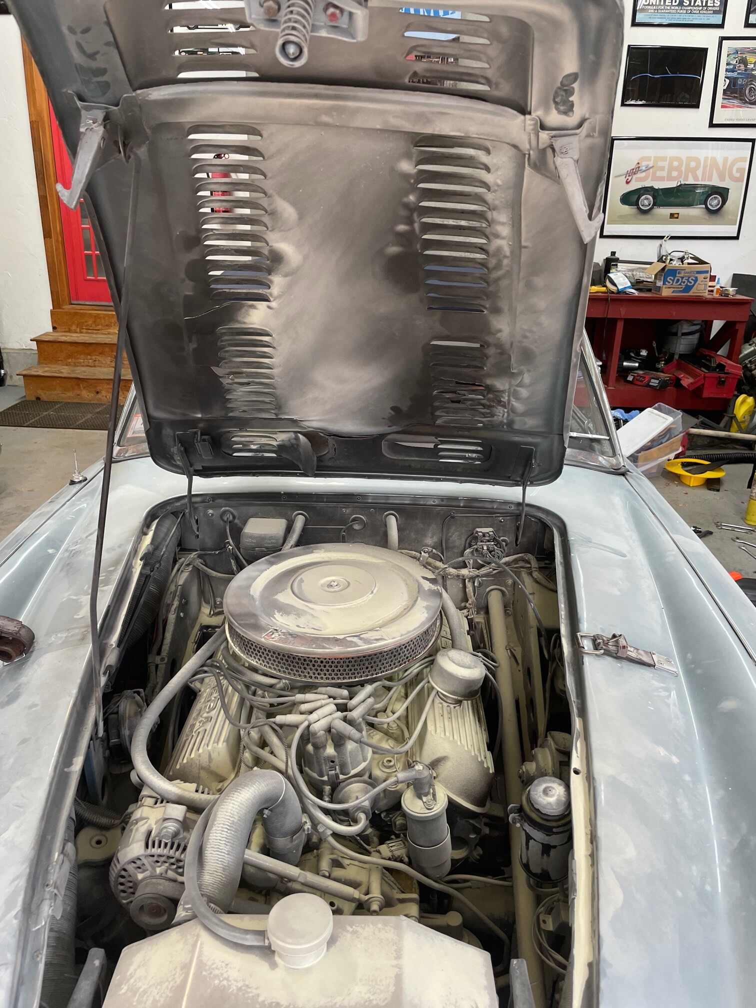

Yes, Halon extinguisher next time around. Fire started from leak in carb where I replaced a filter and probably didn't get it tight enough. Wiring damaged (needed new harness) bonnet needed repainting, engine and transmission out for cleaning, some paint work in engine compartment, carpeting and insulation burnt requiring new carpet set, msd box burnt, GPS speedo box burnt, etc., etc. Just about ready to put the engine and transmission back in.

Thanks. Pictures like that are pokes tonall of us to be careful and consider " what's the worst that could happen". Glad you have something to salvage.
Luckily, I spotted the fire quickly through the louvers and had a fire extinguisher on the tunnel. I was able to shoot the extinguisher through the louvers to knock the flames down before opening the bonnet. Fire damage was confined to the bonnet, none to the shroud. The biggest PITA was I just couldn't find someone to do the repair so I'm having to do it myself. A Halotron extinguisher will be on the purchase list before I drive.
