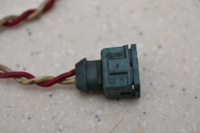

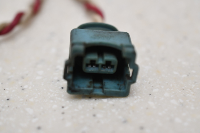

If you want to make up a more permanent rig and not risk shorting and a spark, I made this adaptor to do the job of energizing injectors decades ago. Audi part number 022 906 231 (and I suspect it to be the Bosch number as well) and a couple wire leads to attach a voltage source. Pardon the dirty appearance, it has done its job for many years.

I thought about that but didn’t have the extra connector and didn’t feel like buying one. If it was something I was going to do frequently then for sure I’d make one.
Platinum
It was a "nice-to-have" and I could walk into the parts room and just get the plug outta the bin! Nobody else thought to do it...
Parts guy: "Whadda you doin' NOW?" ;)
