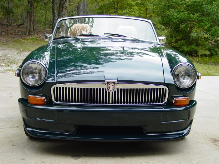

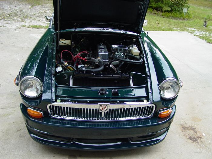

I converted my 78 about 4 months ago using the spoiler/bumper that Tom sells and it fits perfectly. You can make all the cuts to the front frame rail using a angle grinder or a cutoff wheel, of course a plasma cutter is the easiest to use. I will attach some pictures of the finished product and if you look closely at the picture with the bonnet up you can see the cut down bumper frame rail through the grill slats. [image]https://www.britishcarforum.com/ubbthreads/download.php?Number=81838[/image]
heres the one with the visable frame rails
