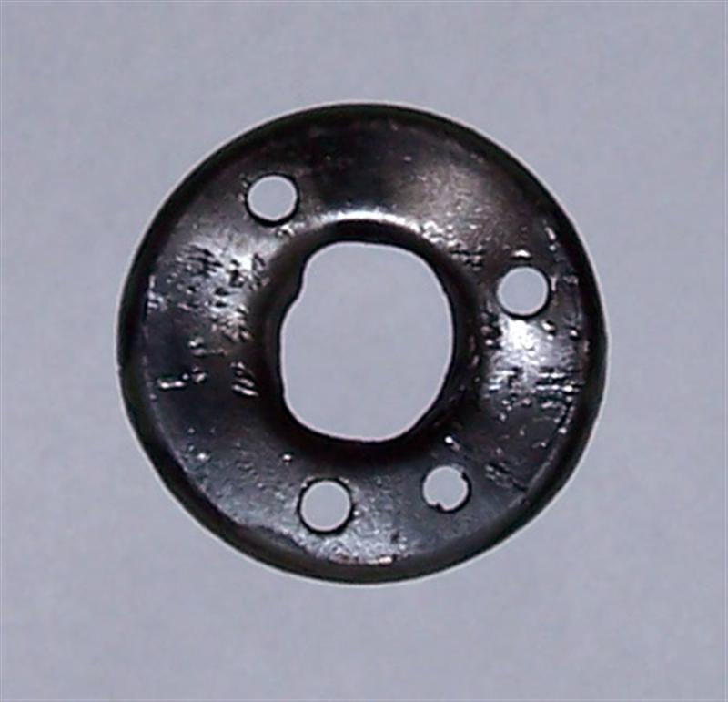

Afraid the pic does not even show how bad it really is. all four corners if you can call em that are worn out of oval and thin as a razor. The lip is really gone.
Just been loking at en expoded diagram of the gearbox on ahspares, and guess which is the only part not numbered...
Isn't there a guy in Maryland with a really low mileage Sprite? Maybe someone could get his part, take some measurements and get some made up?
Pete, the one I just posted pictures of is from a perfectly functioning rib case, 1974, with 42,000 miles on the clock.
I don't know about making any, but I'll pull the dimensions, just in case.

I just looked at the one that came off my ribcase (unknown vintage). It's similar, but that center hole is open on one end??? Am I looking at the wrong part?
Jack, if you want, I'll weld the edge that is slightly worn, toss it on the mill, and straighten it out for you. That will mean that I won't be sending it out until Thursday or Friday.
