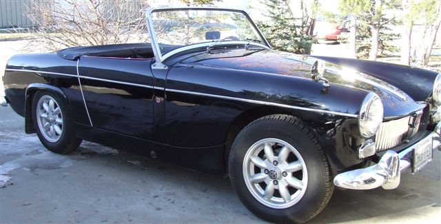

Hey John - Peter Smit, That picture of that car above got my attention. About a month ago when we had a break in the weather I was walking in my neighborhood and saw a car exactly like the one in the picture except it was blue and seemed jacked up a bit higher with bigger wheels. I remember it cause the first thing that came to my mind was getting a picture to show all of you in the forum. Did you sell this or is it someone you know?
Neither - just pulled it off the net - just went back to the website and it doesn't say where it is from, so, there is every chance the one you saw is it - please Lord, let there not be 2!
Wait until you encounter the first speed bump or need to negotiate a driveway. There are limits of how low can you go. Exhaust pipe will be the first thing that hits.
