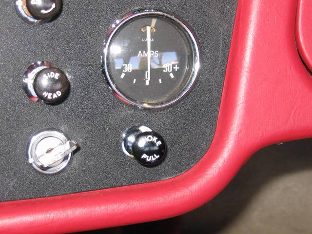

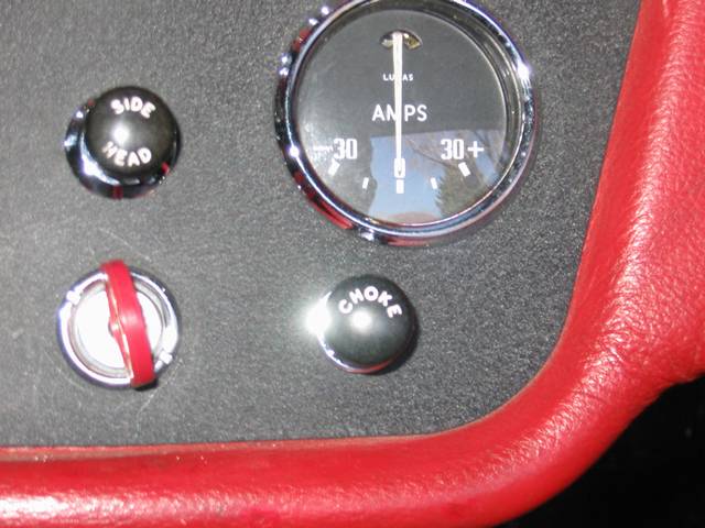

Most of the new retro knobs I've seen have the words "CHOKE PULL". This is what we had to use on the TR3A we finished last year.
When I replaced my cable about 5 years ago, I re-used my original knob which only reads "CHOKE".
I gave my original knob, which had "CHOKE" on it, to John Warfield. He gave me a repro knob the had "CHOKE PULL" on it. It works.
