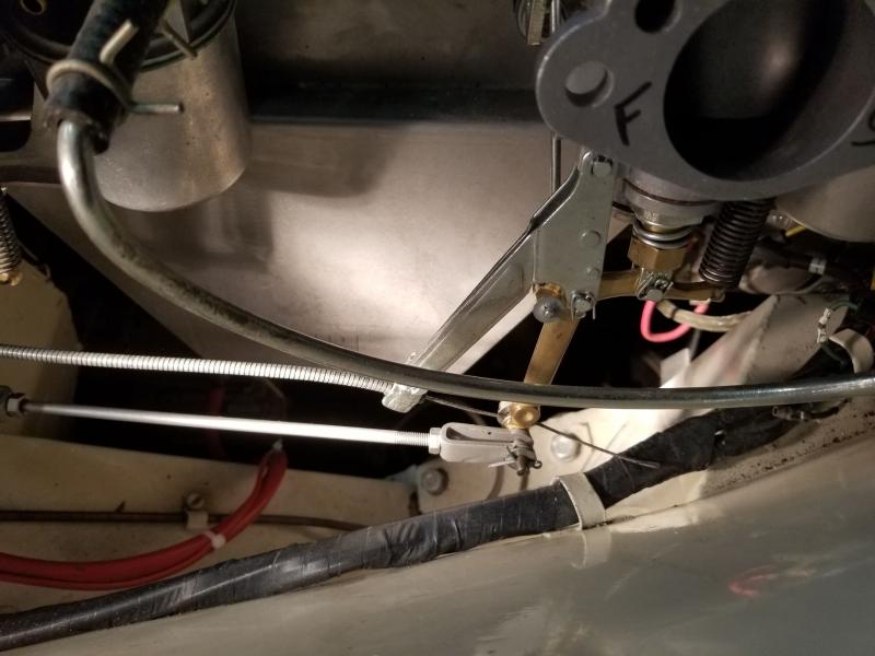

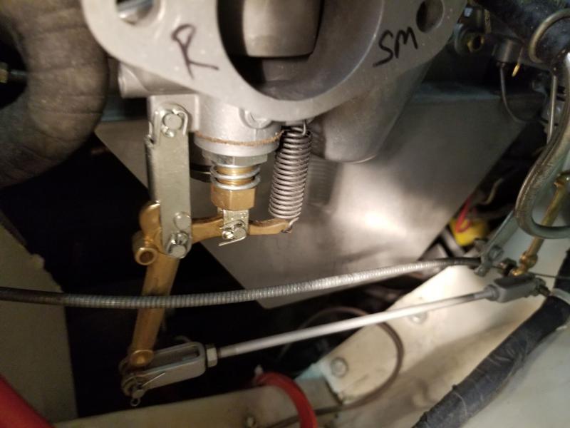

Does this help?
David
Thanks David. My connections match! I was unsure about the rear hookup but if I am viewing correctly, it is between the clevis, not outside?
sp53, I have studied the photograph (page 1) many times and read several other posts but could never determine to my satisfaction the proper positioning.
Thank you,
Jay

There is a great sketch on page 6 of the "More BS about TR's" booklet. It shows the how the linkage is connected.
David

Because of this thread I re-did my linkage and located the clevis on the side. I put mine on the side nearest to the engine, like the first picture shows. This lined up best with the bracket.
The choke operates better this way but I can't figure out why.
