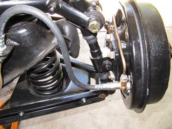

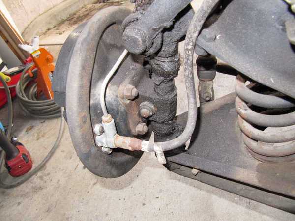

The lines on my TD were pretty bad, too. This seems to be one of those things that POs often don't take care of, even though old rubber lines are a perpetual source of problems. Even stranger in my case, as the car clearly had received a full brake job--four wheels, new shoes, new wheel cylinders, even a rebuilt master cylinder.
Anyway, it's nothing a few new parts, cleaning, and paint can't fix.
